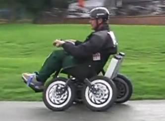

However, if you really need the absolute maximum torque for climbing steep hills, a Pair of Magic Pie 5 motors and dual batteries to enable maximum current to be used continuously would be a better option, or even four motors, one on each wheel:
