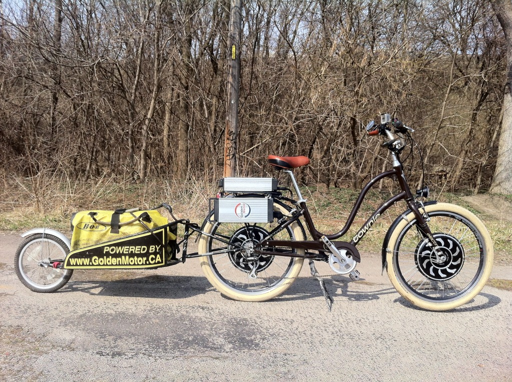

On my Townie I have the "stock" tires that came with the bike. They are "Fat Frank" 26x2.35 ballon tires with Kevlar. Love the colour too! Sort of an off white. I think I'll look into a match for the Bob trailor. I wonder if the Fat franks come in 16 inch. That would really look good :)

Hi Gary.  Wow she looks great riding on fat franks  8)
How do the bags fair on those skinny rims?

The original rims were a half inch wider then the pie rims. The max PSI for the tires is 60 and I was running 30 in the front and 40 in the rear. I did notice a bit of tire roll but nothing drastic. when I put on the trailor I pumped the rear up to 50 PSI. Everything seems fine now, but I do not push it to the limits when cornering. The only real issue I had was since the rims are thinner the brake shoes had to travel farther causing the arms of the brakes to rub on the tire when applied. I since added a few washers behind the shoes and everything is fine now. I have full regen on both wheels so I don't need the brakes much anyway. One thing I did notice with the MP3 is regen works right down to a dead stop. With the MP2 regen only worked down to about 10kph, then nothing.
