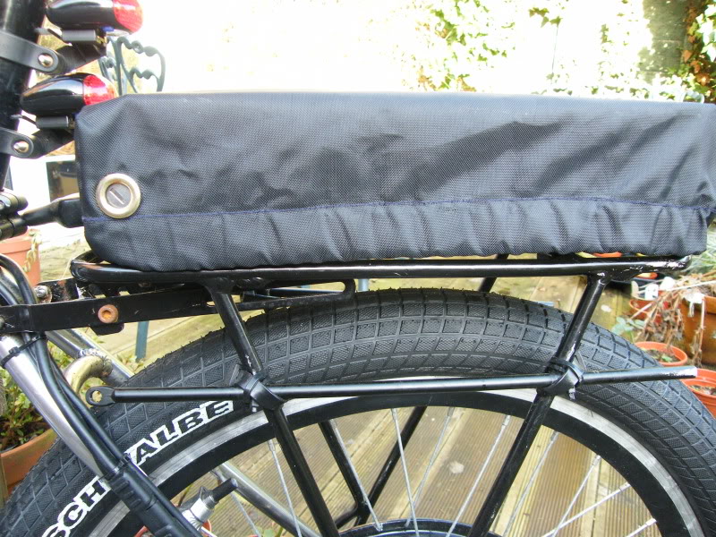

It's good to hear you've finally got it sorted.
Now you need to find a cover like Andrew's:
Click on the above picture for more details.

« Reply #19 on: January 27, 2014, 09:29:17 AM »
Yes, I will certainly use something like this, but mine will cover the key hole too. It was probably one of the places where water came in - the lock was damaged so badly that I could hardly remove the key from it...
