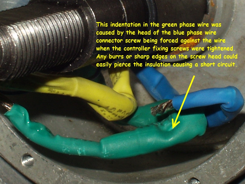

« Reply #6 on: January 07, 2013, 02:24:06 PM »
As the motor was cogging before, there must have been a problem with either the controller itself, or a short short between two of the phase wires.
It's possible that one of the phase wire screw connectors could have inadvertently been forced against another phase wire when the controller was fitted. This could allow any sharp edges on the screw to penetrate the insulation on the phase wire resulting in a short circuit between two phases:
Trying to operate the motor with two phase wires shorted could have overloaded the MOSFETs causing one or more of them to fail, which could also explain why the motor is unable to start on its own.
Fitting a controller that is known to work properly would be the easiest way to confirm if it's a controller problem. ;)
