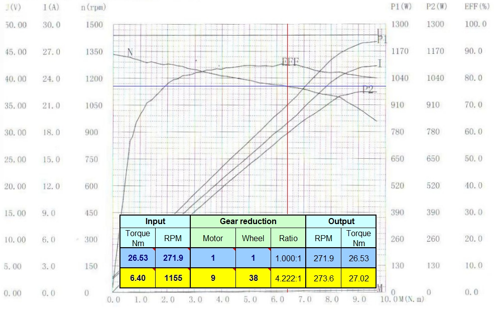

I've just been doing a few calculations of my own to compare these two motors at an equivalent power consumption and output speed.
The Crystalyte (34.87V @ 26.02A) uses 907.6W to produce its maximum power output of 755.2W with a speed of 271.9rpm and a torque of 26.53Nm
The BLT-800 with a 9T to 38T gearing (4.222:1 reduction, 48V @ 18.96A) would require 910W to produce an output of 767W with a speed of 273.6rpm and a torque of 27.02Nm
These output figures are within 2% of each other, but the BLT-800 would probably loose more than 2% of its delivered output due to the mechanical inefficiencies of the chain driven gear reduction mechanism.
It's also interesting to mote that with a 26" wheel, the no load speed of the Crystalyte would be 27.13mph, but the unloaded speed of the BLT-800 would only be 24.41 mph.
If the Crystalyte was running on 48V instead of 36V, the recorded measurements of the two motors would be easier to compare.

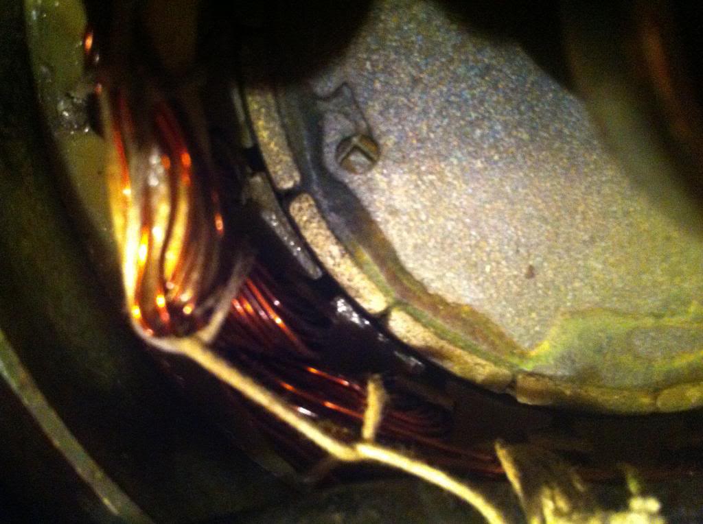

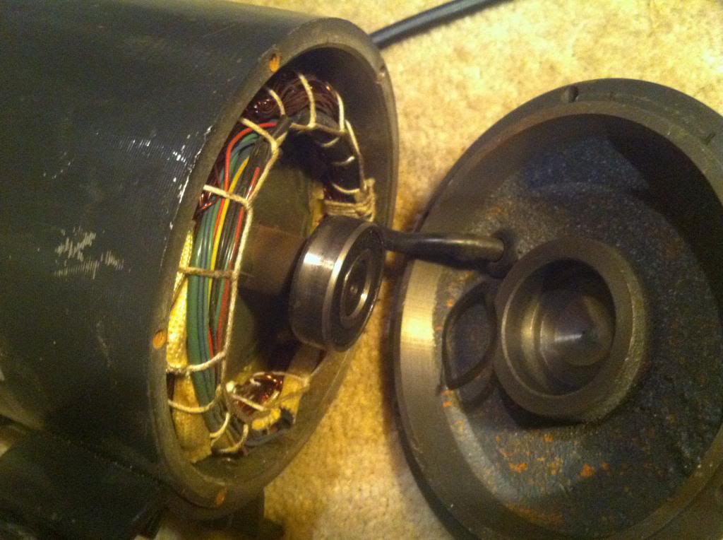

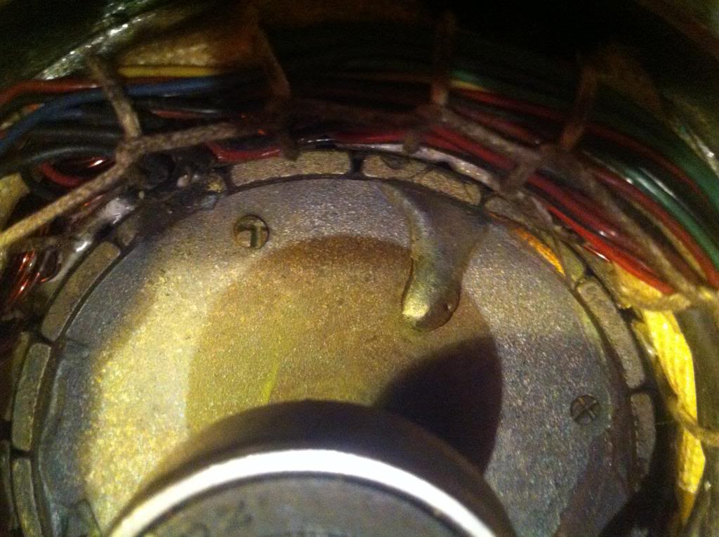

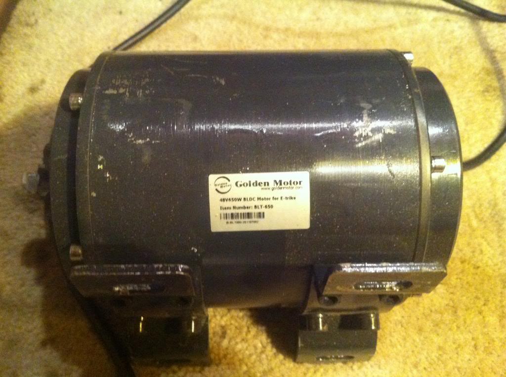

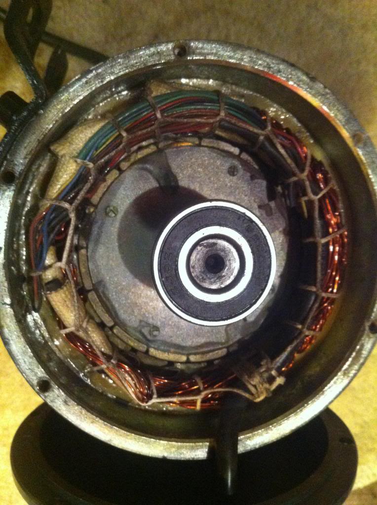

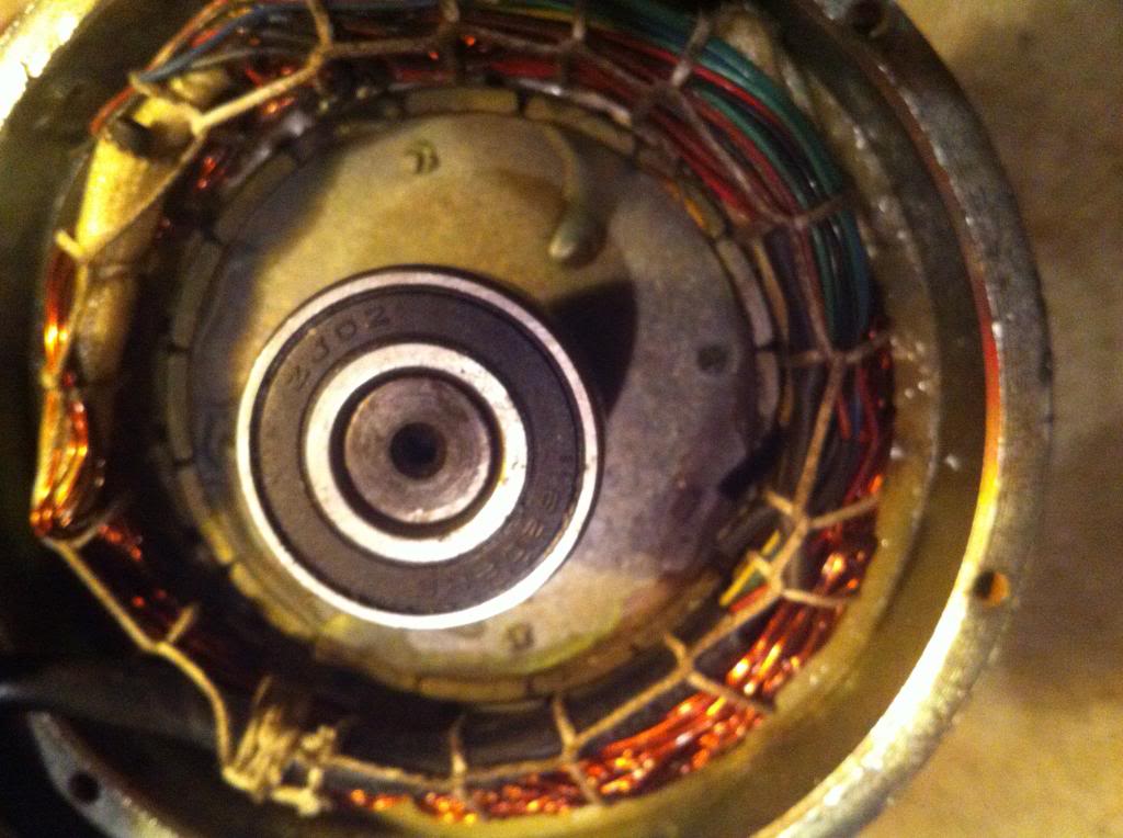

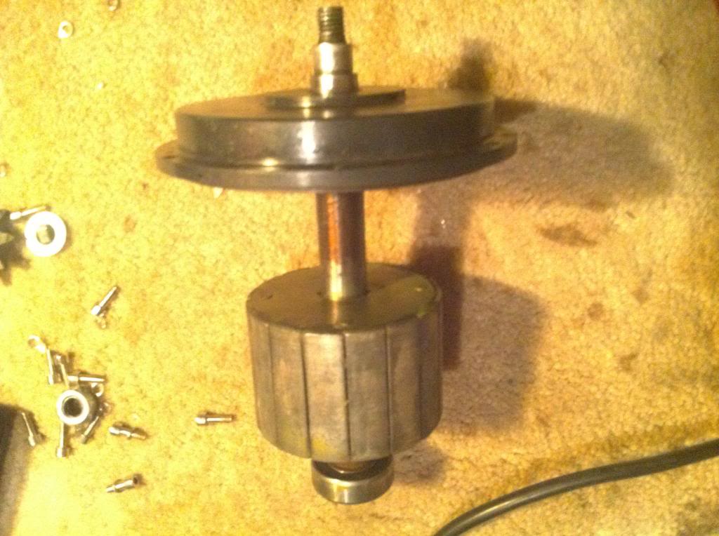

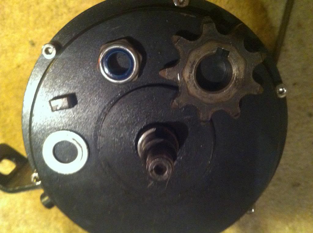

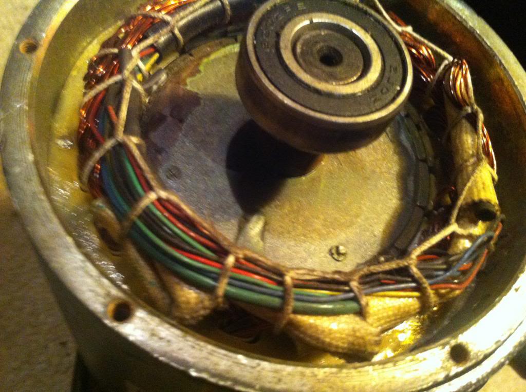

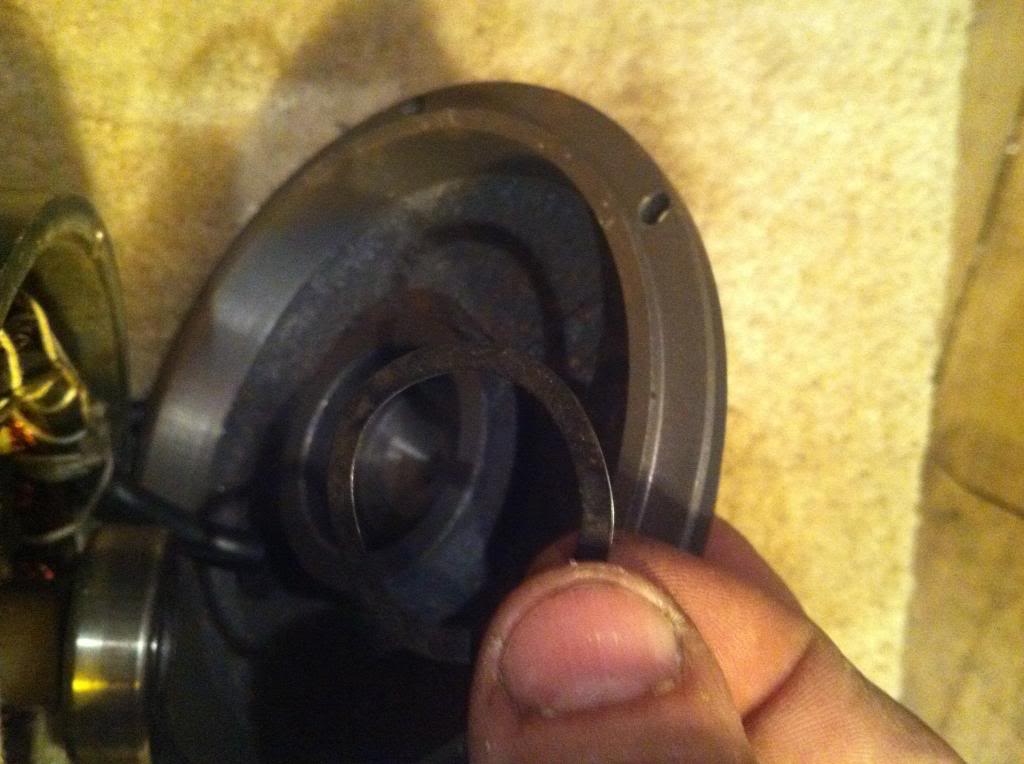

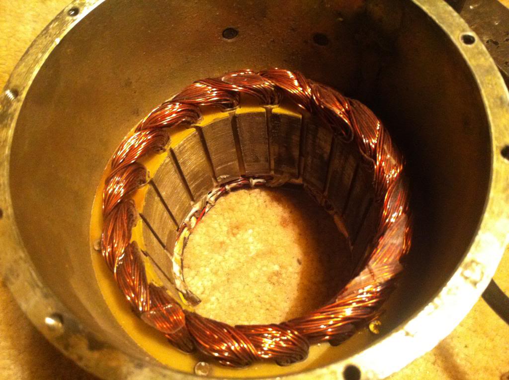

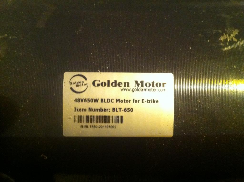

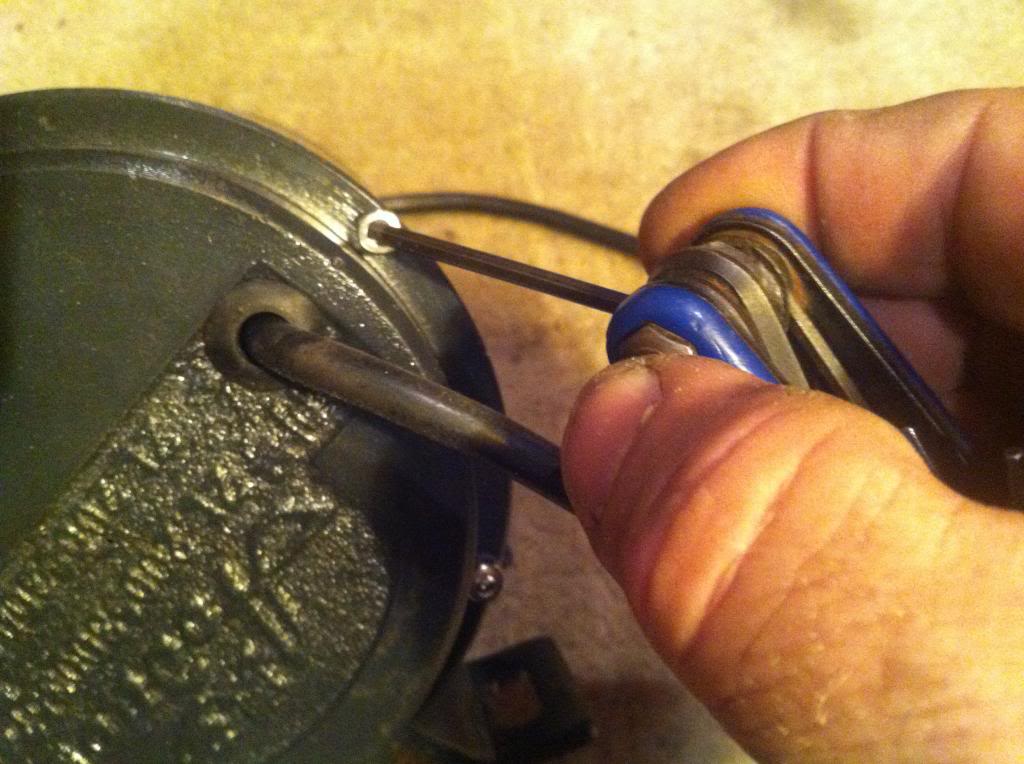

Here you go. Please keep in mind this motor was in use for a while then I believe the hall sensors failed. It was sent back and a new one sent out. This motor then sat for about 8 months before I opened it today. I was really surprised at how strong the magnets are. It took a lot of force to pull it apart. Hope what you are looking for can be seen in these pictures.
« Last Edit: July 02, 2017, 09:21:02 PM by Bikemad »

« Reply #5 on: November 13, 2012, 02:02:03 AM »
Gary; that thing sure isn't a lightweight, lol! I see what they did with the 650w, bit of a cheap move there. Then again, you've got a ton of thermal mass to dissipate heat there for the 650W motor. So the extra steel/aluminum is just a bonus heat dissipator for when you're really hammering it climbing hills :D and maybe room for fans too.
I like the low pole count, it looks like it may spin up on higher voltages pretty good. I wonder if the magnet/axle assembly is hollow on the inside or what. Maybe it could drop a little weight that way.
This motor looks like quite the chunk of magnet and copper, I can't wait to get my hands on one.
Thanks a lot for the inside look; I really appreciate it. Maybe more people will get hip to this motor once I hot rod it :]

There appears to be a lot of empty space inside that motor, I reckon there's just enough free space to accommodate 650 grams of Bacon, Lettuce and Tomato, hence the BLT-650 label.
With a bit of machining, that motor could be made a lot shorter and significantly lighter too, but still have exactly the same power output.
Alternatively, they could have placed dual in-line rotors and dual windings to make the motor a lot more powerful, and the casing looks thick enough to enable grooves to be machined around the main body to increase the surface area for improved heat dissipation and even more weight reduction.
Are you comparing it to the Crystalyte HS, or the 5300 series?
Also, the figures I was using were 'max power' figures given by both motor companies.
I was using the maximum power figures for the Crystalyte HS3440, and simply used the point on the BLT-650 graph where the power consumption was pretty much the same:
I thought this would be the fairest way to compare them.
