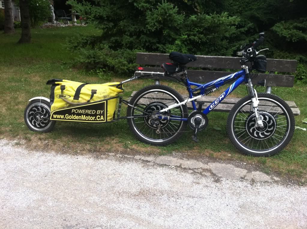

This bike was labeled a downhill dual suspension bike when I bought it.
Original look:
http://www.canadiantire.ca/browse/product_detail.jsp?PRODUCT%3C%3Eprd_id=845524443324981&FOLDER%3C%3Efolder_id=1408474396672192&bmUID=1301967914931
After I was done with it:
Offline ThunderhorseMaker

« Reply #6 on: March 01, 2012, 05:08:21 AM »
A very impressive setup!
Now do it again! Except this time do it with cast MP III all around! A dual-suspension frame that can take 16/18/20 inch wheels is my current dream!

Re: 16, 20 and 26 inch questions
« Reply #9 on: March 02, 2012, 06:29:29 AM »
Success!  ;)

« Reply #11 on: March 03, 2012, 04:07:30 AM »
Wow! now thats impressive, Lets Trade :)
