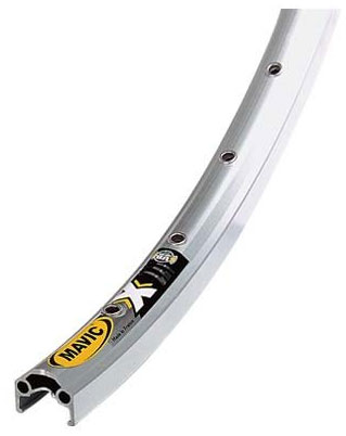

I relaced two out of the three wheels I've installed so far right out of the box.  I put Mavic double-wall rims on, with spoke eyelets and machined sidewalls.  MUCH nicer.

The Mavic rims worked just as they were, with the existing spokes.  The eyelets tend to want to keep the spoke nipples straighter than the spoke wants to bend in order to match the GM supplied pattern, but this minor deflection doesn't cause any issues.
The other thing to remember to get is a decent rim liner.  I think electrical tape would be more effective than the jaggy piece of brittle plastic supplied with the original wheel.
This is the model of Mavic Rim I am using - I paid $39 (Canadian) for them.
That's the Mavic "X221 UB".  The machined sidewalls are just so much nicer for braking than the GM one which, apart from the seam, didn't have parallel sidewalls to begin with.

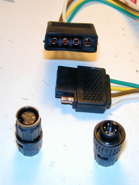

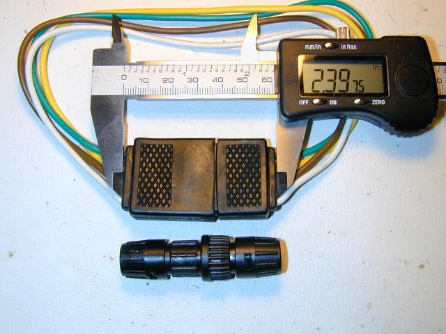

I went through the same thing you did, working on one of the three bikes.  I had the back wheel off that bike a few times, and every time I took the thing off, I was cutting a bunch of wire ties and using a bunch more to put it back together.  I looked around for a solution to make it possible to put a quick disconnect in the line near the wheel that wouldn't be too bulky, but would also carry the juice to the motor.  There were a few things that grabbed me, but none were really cost justifiable (connectors can be expensive!).
What I wound up doing is putting the 5 wires to the hall sensors through a separate weatherproof LOCKING connector, and using an inexpensive ($4.50 at the local Sayal Electronics) trailer kit for the phase wires.  A little shrinkwrap tubing, and it all goes together tidily.
Here's a picture of the connectors used...
Connected together, they're just over 2 1/4 inches long...  One of the wires in the trailer connector, obviously, isn't used...
I have the DigiKey part numbers for the connectors for the hall sensors around here somewhere, if anyone's interested.  I seem to recall that the pair (male/female) cost me around 10 or 12 bucks Canadian.
Thanks for that, Phil. I had thought of using the trailer wiring also, but after looking at the link above from biohazardman, it appears that there are also three-contact connectors of similar design.
As for the Hall sensor leads, since there isn't likely much current being carried there, I had thought to use some kind of computer connector for that... something like a PS2 or Mac serial plug. But I do like that one that you found that has the locking ring on it. And the weatherproof aspect is appealing. It would be nice to have something not so bulky though. Another thought from the wiringproducts.com link is to use one connector for the three phase leads and the Hall sensor leads. There is this eight-contact connector:
Way overkill for the Hall sensors, but I think it'd get the job done.
