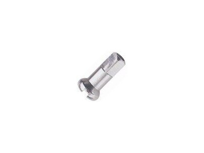

When I got the wheel with the engine was broken three spokes, so that the loose screws that hold the spokes attached to the wheel frame was loose inside the wheel frame (between the hoses and the wheel). So when I bike so it sounds like some loose marbles inside the wheel. Now I have three loose spokes that I have to get attached. But how?
Kristoffer, check out this post for more information regarding the refitting of the spoke nipples.

Regarding the spokes was a very loose when I received the package, also released another during the first test ride I had. I've tried turning the other a little better place (without removing the tire). I do not think I'll try to attach the spokes on the bottom of the wheel since it requires so much "fiddling" ('m afraid I ruin everything). But maybe I'll try to attach a little super glue around the mounting screws until the spokes, so they do not fall under the wheel frame.
If you want your wheel to be good and strong, you must refit the nipples which have come off!
If you're really not bothered about the possibility of the wheel collapsing suddenly while you are riding the bike, you should at least wear protective clothing (helmet, gloves, knee pads, elbow pads and a gum guard etc.) on every ride, so you are prepared for the inevitable failure of the wheel when you hit a big bump (or pothole) at high speed.
I don't suppose you would be quite so keen to jump in a car and drive off down the road, knowing that one of your wheels was likely to fall off at any time. All because you couldn't be bothered to refit the several wheel nuts rattling around inside the hubcaps, because it would require so much "fiddling".
If you're really "afraid of ruining everything", then refit those nipples before the wheel is ruined.
Refitting a few nipples will be much easier (and cheaper) than completely rebuilding a collapsed wheel!

Hehe. You are good at scaring people. I was thinking to buy a puncture-free tires to the wheel and when I have to take any of hose and tires, so I can watch it then. Now only two of the spokes loose. I buy the maximum 25 km / h now, and it will take approximately three weeks before I order the hose + new battery here at Golden Motor (so it takes about 3 weeks before I get the new battery + cover.) Do you think it makes so much I bike carefully with two loose spokes in a couple months before I fix it? I have to buy any new mounting screws to the spokes when I get a salary, since one of those were already gone when I got the package home last week.
Do you know where I can buy new mounting screws for the spokes?  ???
Kristoffer, as it was missing when you received the wheel you should notify GM, and hopefully they can send you a replacement spoke nipple.
Alternatively, it might be much quicker to simply buy one from your local dealer (assuming they have them in stock):

I wouldn't want to continue using it for two months without all the spokes being fitted correctly, just in case.
