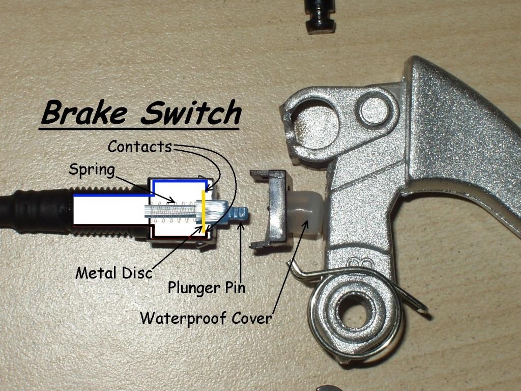

Actually the regen was still not working in that video.  The brake lever on the right/throttle side is for the rear brake.  You can see the front brake pads in the video and they do not move.  Anyway that is irrelevant as I've found the source of ALL my issues, well bike issues anyway.
Both the  "Brake then immediate throttle = nothing on MP4" and "Magic Pie 4 regeneration not working" were caused by a faulty brake switch!  If I unplug the faulty brake and test with only the other brake lever all my issues are solved.  If I then take the good brake lever and plug it into the other 3 pin port of the wiring harness it works as well.  This leads to the conclusion that the right hand brake lever is bad.  The other symptom I notice is that when I activate the faulty brake lever the controller will issue a slight whine.  I assume this whine is caused by the 5 volt rail getting shorted out.   I'm sure Gary at GM Canada will be relieved to have this problem solved as we had sent controllers and finally the whole wheel back under warranty.
I would like to thank Alan and everyone else for their help resolving this issue!

Well done Ron, I'm glad you've been able to locate the source of all your problems.
I never even gave the brake levers a second thought as the brake switches have always been connected by just two wires, and as your switches were cutting the power, I naturally assumed that the switches and their wires had to be working correctly:
The annoying thing is that it was only a few weeks ago that I spent some time checking out and recording all the connections on the MP4 harness:
This was when I discovered that there was an unused +5V supply to both of the brake switch connectors which is presumably ready to allow non-contact Hall effect brake switches to be used instead of mechanical contact brake switches:
The strange thing is that all of my recent MP4 and Smart Pie 4 brake switches still use mechanical switches that only requires two wires to operate correctly. I guess the additional wire is in the cable but just left disconnected at the switch end, but I suspect that in your case, the wrong wire has somehow been allowed to touch against the brake switch contact by mistake.
