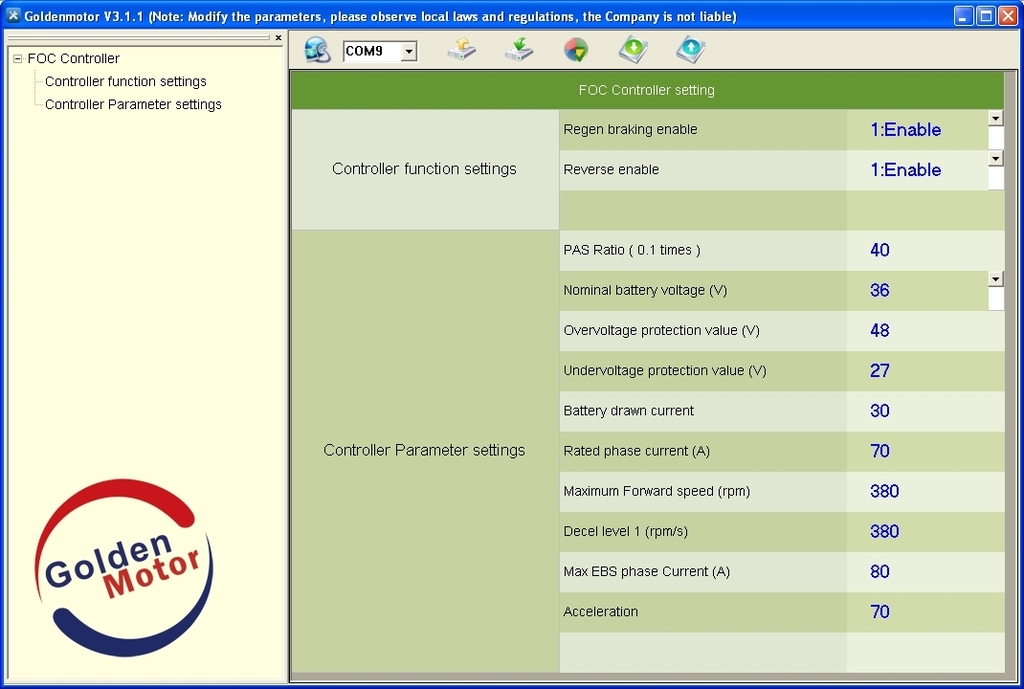

I've got about 100km on my new vector mp4 and I'm loving it.  My problem is that the regenerative braking is not working.  I've got the programming cable and haven't figured out how to enable it.  My bike uses a 12s lipo pack so I set the controller for 48v.  I know the controller is seeing the brake inputs as the throttle gets cut when I press either brake.  The attachment is a .png with the latest controller parameters.

It looks like your regen is already enabled so I'm puzzled as to why it doesn't work.
Did you reload the stored setting from the controller to make sure they had been saved correctly or is it possible that the 48V battery voltage setting might not have been saved?
Do you have any form of diode in your LiPo pack that would prevent the pack from receiving regenerative charge current?
Does it make any difference if you set the "EBS Peak Phase Current (A)" to 80%?
I notice that the software you are using shows "Maximum Reverse Speed (rpm)" instead of "Decel level 1 (rpm/s)" so it might be worth trying another version of the program to see if it makes any differerence.
Try setting it up with "LBMC_GUI_v3.1.2_GoldenMotor.exe" which is in the Dropbox folder and see if it makes any differerence.
I think the "Decel level 1 (rpm/s)" can be set up to a maximum of 380.
If it's still the same try the other one too "Revised GM_v3_1_1(201406231)_GED.exe".
When I used the wrong software on one of my controllers it would adjust and save the Acceleration setting in the controller but it made no difference to the motor's actual acceleration which remained the same on 20, 40, 60 80 and 100%. ???
It might be worth setting the acceleration level to 20% just to see if it changes. If it makes no difference to the motor's acceleration then you are probably using the wrong software. ;)

Thanks for your reply.  This is what I have found so far:
- I did reload the parameters from the controller and they were correct, the bike is setup for 48v.
- There is no diode on my battery pack.  The lipo's are naked without any BMS on them.
- Setting "EBS Peak Phase Current (A)" to 80%  makes no difference.
- I've used both of your parameter changing programs and one from GM Canada.  All three programs give the same no regen result.
- I was able to change my current from 25A to 30A and it did work.  I tried changing it back to 25A but regen was not effected.
- I also tried loading default parameters with no change.
- The last thing I tried was manually deleting the parameter values and reentering them with no success.
Ron.

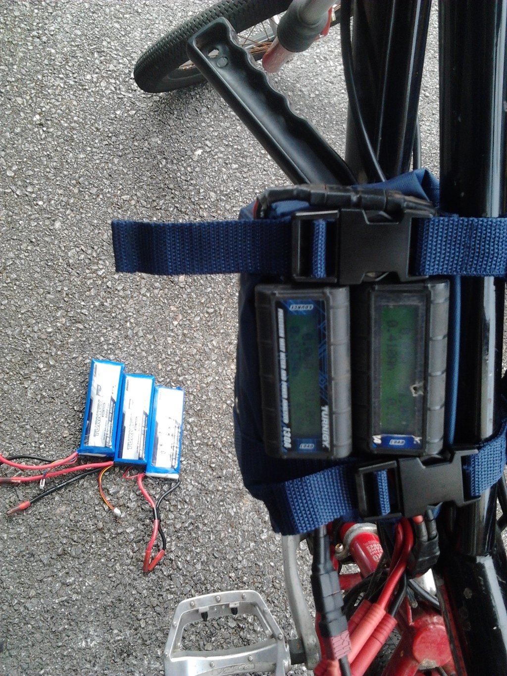

I was wondering whether the your regen problem was due to the 12S LiPo pack you were using so I carried out some tests today on my MP4.
I have a 1S pack, a 2S pack and a 3S pack in addition to my normal 4S hard case packs so I've been doing some testing today using a LiPo pack made up of between 8 to 13 5Ah cells:
Using 12 cells (to simulate your pack) and the default 48V setting the regen worked every time.
I also tested 8S, 9S, 10S, 11S and 13s and regen works with all of them if the voltage in the controller is set to ensure they are within the usable voltage range, so I still don't understand why your regen doesn't work.
The shunt for the Cycle Analyst should make no difference whatsoever to the regen.
I have also discovered that I can run my 8S pack on a modified 36V setting (instead of the modified 24V setting I had before) and with the "Undervoltage protection value" set at 27V it can still discharge the cells down to 3.375V each which is ideal for my use.
Unfortunately, the lowest voltage I could enter on the "Overvoltage protection value" was 48V but as I don't do much high speed braking normally on this bike it shouldn't really be a problem.

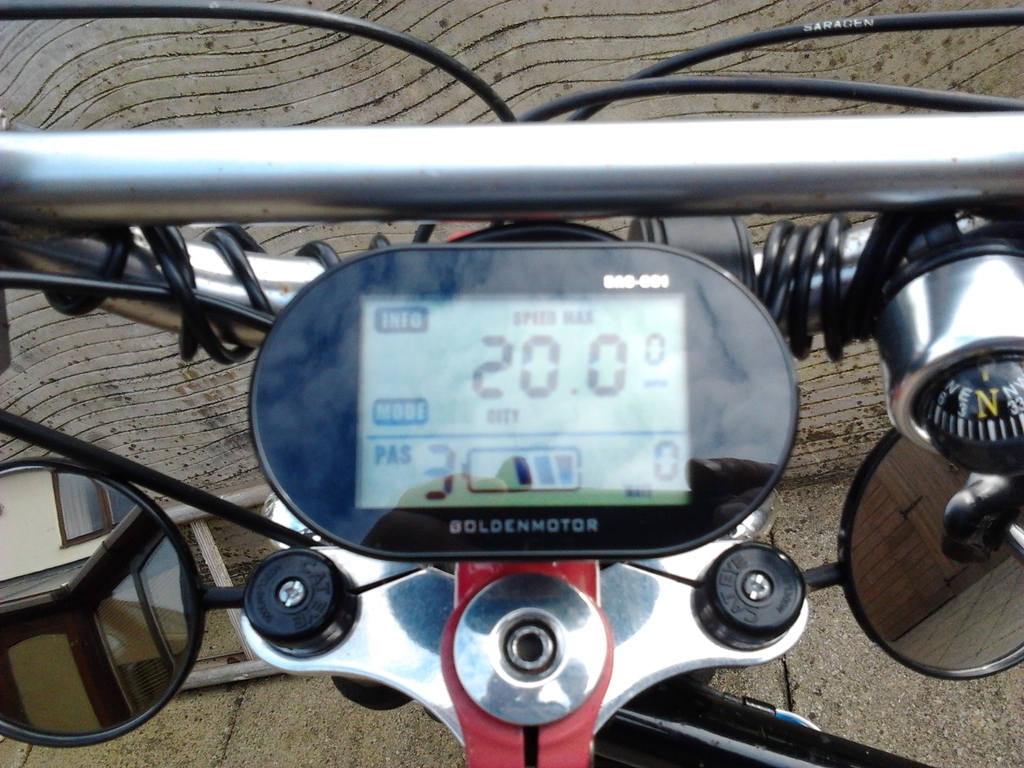

On the 36V setting the battery gauge also works much better on the Smart LCD Display:
On the 24V setting it always remained full even if the battery was half empty. ::)
I also did some testing using a pair of wattmeters to measure the regen current and here are the result:
Maximum wattage was 892.8W under power and 567.4W generated during regen @ 21.87mph with ~31V battery voltage.
Maximum current was 29.98A under power and 17.92A produced during regen.
I tried the same test later when the battery voltage had dropped and the regen result was much higher:
Maximum wattage was 798.2W under power and 805.2W generated during regen @ 20.00mph with ~30V battery voltage.
Maximum current was 27.46A under power and 26.12A produced during regen (shown on the lower wattmeter):
Even at my relatively slow speeds of 20~22 mph the regen definitely produces a lot of power!
