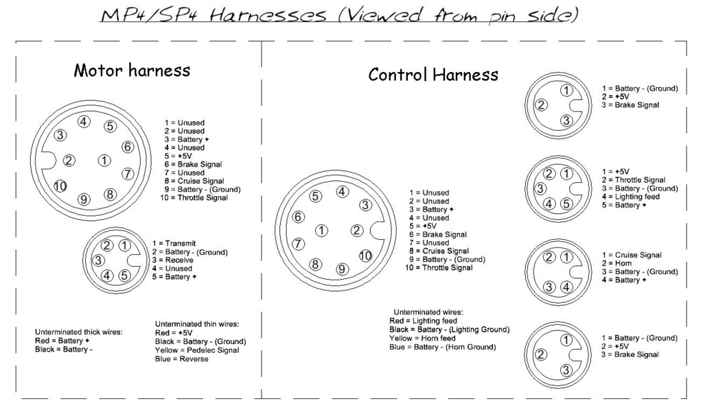

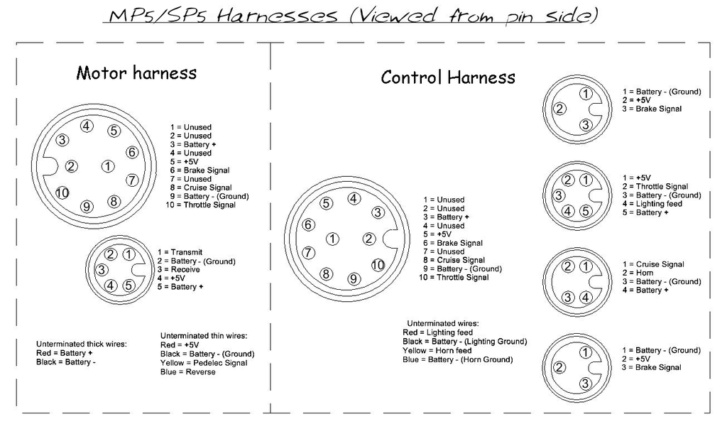

If the motor diameter is approximately 310mm you most likely have Magic Pies:
As you have the 10 Pin connector they could be any of the following three options;
  • late version MPIII
  • MP4
  • MP5
The wiring of the MPIII, MP4 and MP5 motors is very similar except the MP5 had the additional +5V supply on the controller's 5 pin connector.
The 10 pin connector connects to the control harness similar to the one shown below:
The 5 pin connector is used to connect to the USB programming lead, the LCD Smart display or the Bluetooth dongle on MP5.
Check out this post for more details regarding the cables on the controller.

The motor shown in your photo is a Smart Pie, but the wiring should be the same as the MPIII, MP4 or MP5 dependent upon which version of the Smart Pie it is.
Your Fat Wheel version will probably have a longer axle and wider dimensions to the ones shown below:
You need to measure the voltage on pin 4 relative to ground (B-) with a battery connected.
A 12V battery should be sufficient to produce the +5V supply on Pin 4 if it is a later controller.
Unfortunately, it can difficult to tell the difference between the early Smart Pies with the Square wave controller and the Smart Pie 4/5 with the vector controller until you hear them under load. The noise emitted from an early Smart Pie increased with the load, whereas the minimal sound emitted by the later motors with the vector controllers only varied with wheel rpm. It did not noticeably change when under load or with the throttle released at the same wheel rpm.

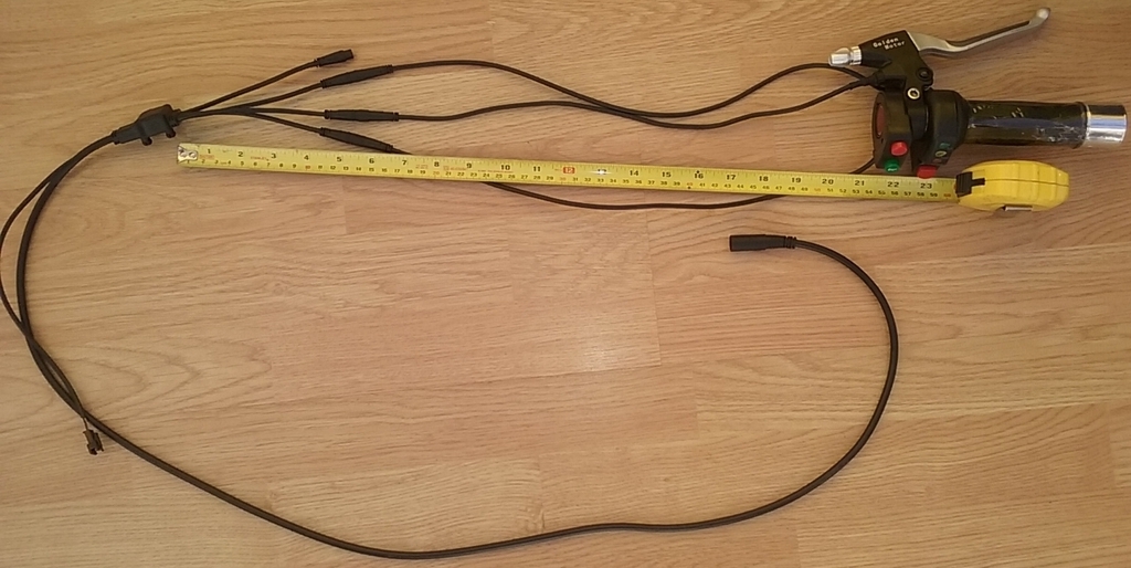

I have a feeling I will see 5volts on that pin, I have luckily also found the harness controller cable, I attached a photo,  now my question would be if I actually manually give these signals to the control harness pins, so I assume the throttle signal can be either on or off, or an pwm signal type, so if I give this signal some voltage it should indicate throttle on to some extent? I also have a question what would the cruise signal indicate.
I can see two types of voltages battery or 5v coming from controller. Trying to get the basics of it :) .

So I assume the throttle signal can be either on or off, or an pwm signal type, so if I give this signal some voltage it should indicate throttle on to some extent? I also have a question what would the cruise signal indicate.
The throttle signal wire requires a voltage of ~0.8V to 4.25V to control the motor speed. The motor should start to turn with a throttle signal voltage of ~1.25V and maximum motor rpm is reached at ~3.25V. Below 1.25V it will not run at all, and above 3.25V it will simply remain on full throttle.
The cruise signal wire is simply switched to ground (B-) when the cruise button is pressed to activate (or deactivate) the cruise function. Applying either of the brakes (or twisting the throttle) will also deactivate the cruise control.
It would be great if we can allow higher resolution images.  always have to try to down size the photos :)
Your attached picture of the control harness is a whopping 4032 pixels wide and 3024 pixels high! :o
Full HD is only 1920 x 1080 and 4K is 3840 x 2160, I really don't see a need for excessively high resolution images (or their associated large file sizes) as attachments on this forum.  ;)
