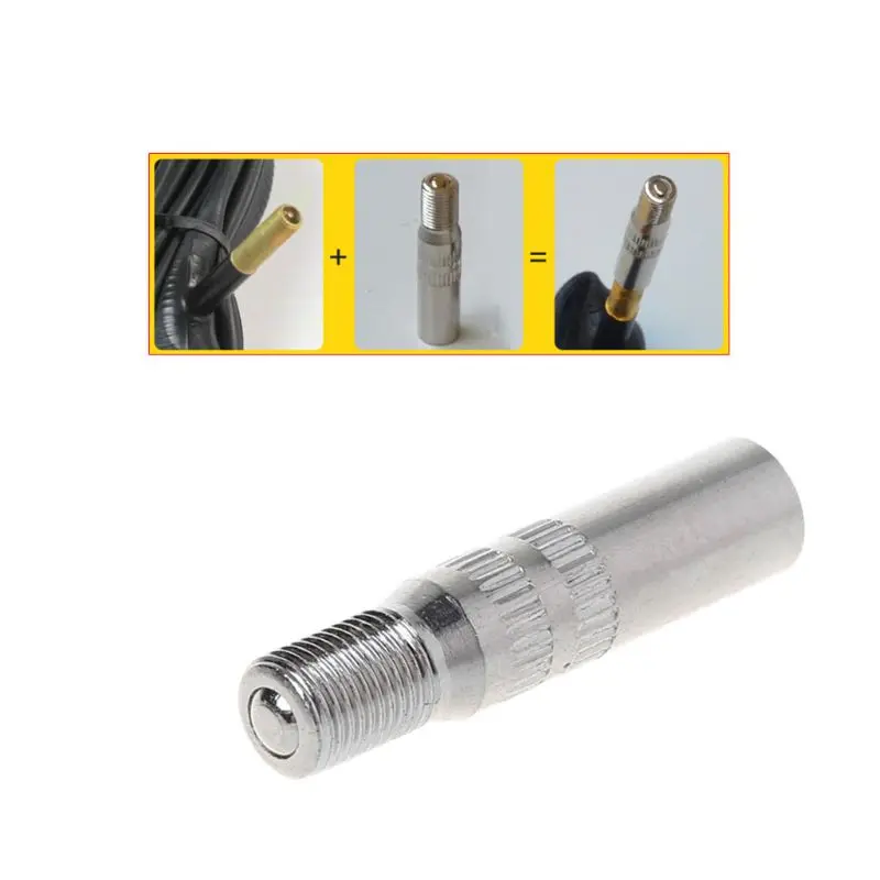

Perfect, I have 700x35. Do you think that a 48 mm valve stem will work or do I need a 60 mm stem?

I use schrader valves (car style) in preference to Presta as they're a much better fit in the larger GM valve holes.
A schrader valve also allows you to easily remove the valve core to enable slime sealant to be pumped into the tube to give better long-term protection against punctures and slow air leakage.
With the deep "V" GM rims, a longer stem is always preferable to a short one, as it is better to have too much valve protruding from the rim than too little.  ;)
I have used shorter 40mm schrader valves but they can be very difficult to inflate from flat as they will easily push back into the rim.
I would always use a screw on extension to prevent this from happening and then remove it once the tyre had been properly inflated to hold the valve in its correct position.
