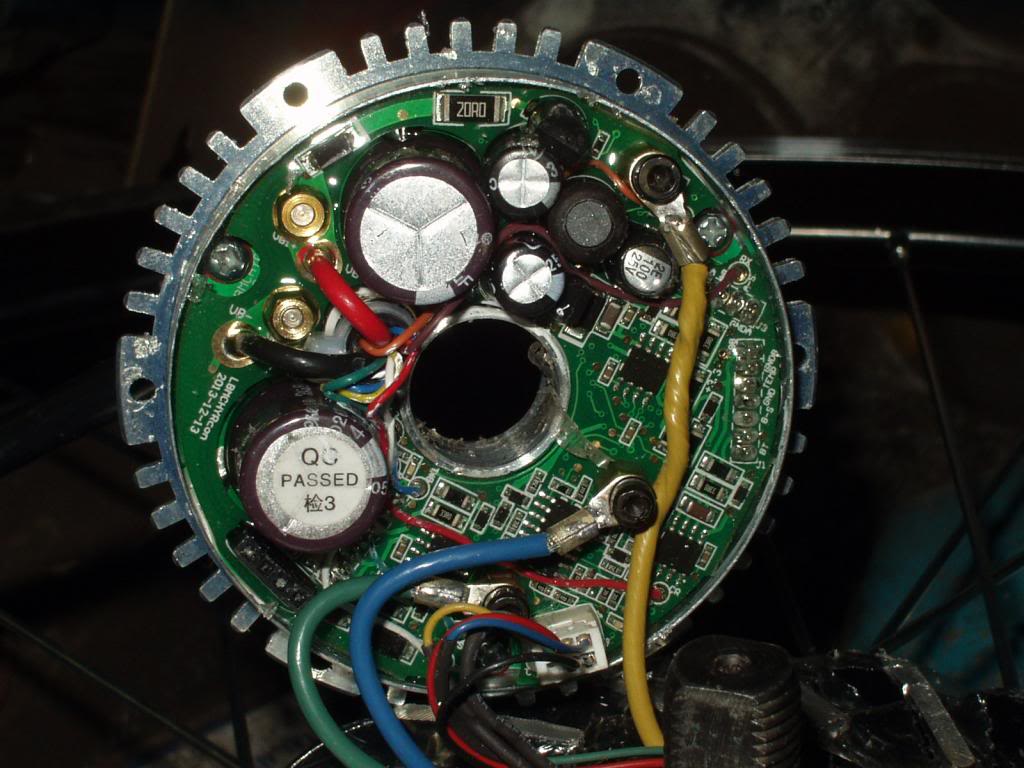

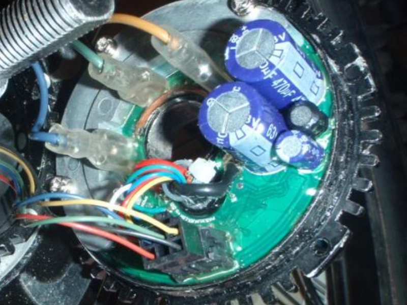

2) At first I thought it was a dead controller, so I got a new one (with Bluetooth). Managed to break one of the spade
connector tabs on the new controller, way to tight of a fit... Got a new 36v battery, found the old controller to be ok when I connected to it via USB (with the new battery). Now I`m all wired up but when I touch the throttle the wheel
seems to "arrest" itself. I can hear the motor "fire" but the wheel does not turn. If I "flick" the throttle (thumb) the wheel tuns a tiny bit but stops. I have tried to "kick start" but no help.

2) As you have replaced the controller, it is possible that the three thick Phase wires (Yellow, Green and Blue) may not be connected to the correct terminals on the back of the controller. If these are not correct, the motor will try to "arrest" itself.
If you took a photo, or made a note of how they were originally fitted, it is possible that the new controller (especially if it is a slightly newer version) may use a different configuration on the Phase wiring compared to the original controller.
Were your Phase wires connected in the same configuration as the one shown below?
Hopefully it will be something very simple.

Hi Alan. Thank you so very much for your time. You seem to be the "go to guy" both here and at Endless Sphere.
I`m a bit of a McGyver when it comes to mechanics, electronics...not so much :)
This was the first version motor and controller of the MP5 with USB (no Blu-tooth).
As the controller came out, being the first time dismantling, it kinda popped off ripping wires off their respective
spade connectors. The connectors have since been fixed. I assumed that all controllers had the same phase configuration?
(yellow, blue, green) the same as in the photo? Do you know of any other config?
Thanx again for help

« Reply #3 on: September 14, 2018, 05:46:27 PM »
You where right. I switched the yellow and green phase wires and motor is on :)
