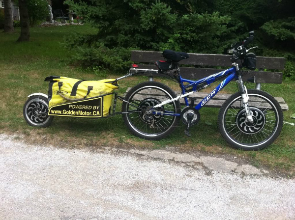

I personally would choose a single or twin wheel trailer in preference to a four wheel trailer, as this avoids complicated steering and suspension mechanisms (and should roll easier on uneven surfaces), and it should also help to keep the weight of the trailer down.
The additional nose weight acting upon the trike's rear wheel is a good thing, as it would help to prevent the wheel from locking under heavy braking.
Much safer to have more weight on the driven/braked wheel and less in the trailer than the other way around.
