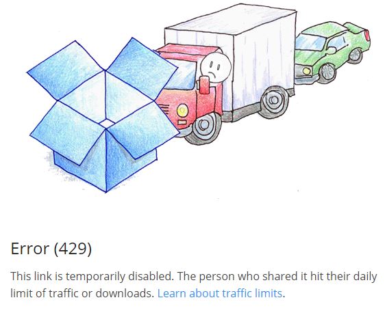

  • Posts: 5,608
I tried to download the older APP versions from the Link, but nothing there...
I have attached the files in this thread as Dropbox are still preventing access to the shared folder:
Quote from: Dropbox.com
Traffic limits
Links and file requests are automatically banned if they generate unusually large amounts of traffic.
Dropbox Basic (free) accounts:
20 GB per day: The total amount of traffic that all of your links and file requests combined can generate without getting banned
100,000 downloads per day: The total number of downloads that all of your links combined can generate
Dropbox Plus and Business accounts:
About 200 GB per day: The total amount of traffic that all of your links and file requests combined can generate without getting banned
There's no daily limit to the number of downloads that your links can generate
If your account hits our limit, we'll send a message to the email address registered to your account. Your links will be temporarily disabled, and anyone who tries to access them will see an error page instead of your files.
There is no way that I have exceeded 20GB per day (or 100,000 downloads per day) as I am only sharing ~20MB of files in total, and I haven't even received an email from Dropbox either.  ::)
A quick Google search reveals that I am not alone, as they don't seem to want Dropbox Basic (free) users and are probably doing this to force us into upgrading to a Dropbox Plus or Business account so they can extract money from us.
Unfortunately, I don't agree with these tactics and have no intention of upgrading when they are obviously unable to provide even the basic services that they offer.
I will try and send you the Bluetooth.Apk files via email if I can.
« Last Edit: July 12, 2017, 10:45:52 AM by Bikemad »
