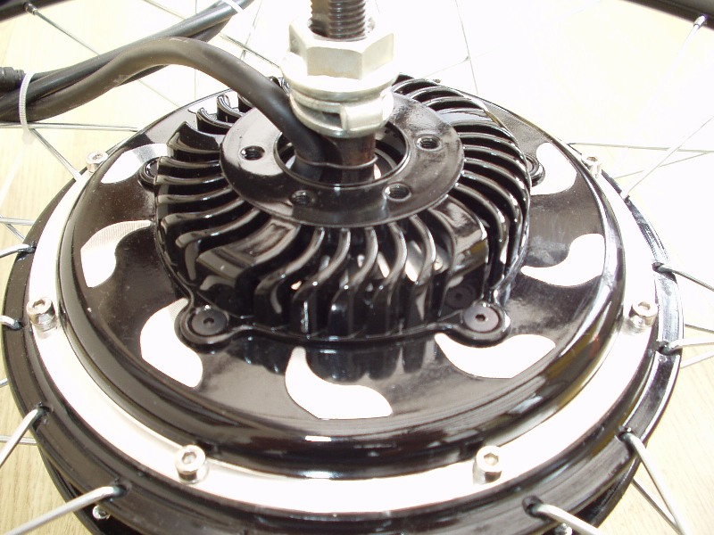

My rear Magic Pie Edge uses 5mm bolts to secure the brake disc, but 12mm long bolts are slightly too long for mine as they would touch against the controller.
The rear brake disc mounting fan assembly has a steel insert where the 5mm threaded holes are:
But I suspect that your brake disc bolts directly to the cast side cover of the motor, and 6mm bolts were probably used to provide a more secure fixing into the softer aluminium threads.
I suggest you check how far the bolts will thread into the holes before they begin to bind, and if the gap between the head of the bolts and the side casing is larger than the thickness of the brake disc, then you will need to use slightly shorter bolts or add washers under the heads of the bolts to ensure they will clamp the brake disc correctly.
