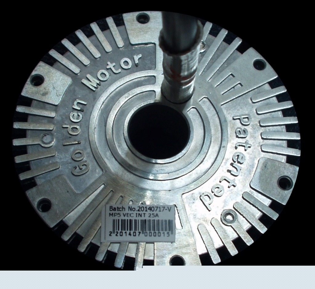

Does your USB lead have the correct 8 or 10 pin connector to fit the main harness connector? Just in case the wrong USB cable has been supplied by mistake. Although, the MP4/MP5 cable (which only has a 5 pin connector) would have shown up differently in device manager. ::)
Also, if they had supplied an MP4 or MP5 instead of the MPIII you would have a similar problem.
It might be worth checking the label on the controller to see what it says, just in case.  ;)
