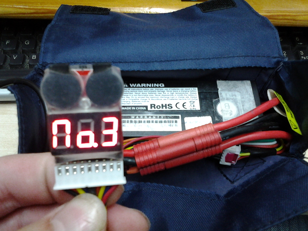

Brian, the alarm function is only for my homemade LiPo packs, the GM packs don't need one as they have their own BMS to protect the battery.
The three types of battery monitors that I use are commonly used throughout the R/C modelling community for monitoring LiPo and LiFePO4 battery packs:
I thought I would just clarify this to avoid any further confusion.  ;)
