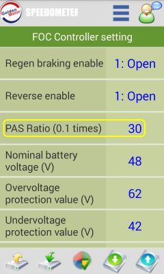

Have you tried adjusting the PAS Ratio using the Bluetooth App to see if it makes any difference?
