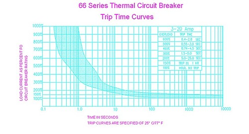

I have just had a quick look on eBay and found this 30A 50VDC circuit breaker available from China at a reasonable price, which might be more suitable for a 48V pack:
According to the following graph, it should also be able to supply 45 Amps for up to 11 second bursts or 60 Amps for 5 second bursts before it would actually trip:
This should be able to supply full current to a standard Magic Pie even under continuous high load conditions without tripping, but it should trip reasonably quickly if there was a direct short in the wiring (although I suspect that the battery's BMS may shut the power off first).
