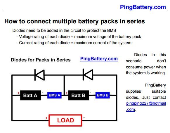

Using batteries with different Ah ratings in series is not recommended and the lower capacity battery could suffer.
Adding another 36V 10Ah battery should be OK if they have the same chemistries (i.e. LiFePO4 or LiMn etc.) but it is recommended to add suitable diodes to protect both of the battery's BMS circuit boards:
« Last Edit: July 04, 2017, 11:32:16 PM by Bikemad »
