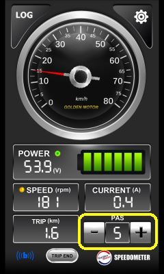

If the controller needs to be replaced, it should be possible to upgrade your MP4 by fitting an MP5 controller (and the plug-in Bluetooth unit) to allow pedelec control via an Android 4.4 or higher Smart Phone (currently awaiting release of the iPhone app):
Unfortunately, the five power levels are not as progressive as you might expect and they are not individually adjustable so I tend to mainly use levels 3 and 4 most of the time.
