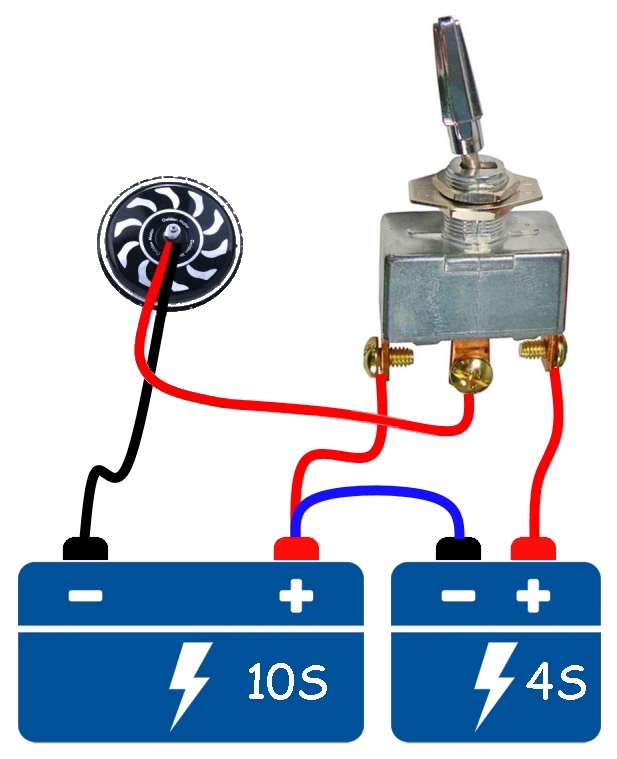

But I paid 3 times that price at Canadian Tire.  I've sketched out how I have it wired up.  It's not exactly what I'd call a circuit diagram but I hope this is enough to explain it.  Thank you for looking over this for me.
Re: Simple, cost effective way for temporary high voltage fun
« Reply #11 on: June 03, 2015, 04:16:06 PM »
The way you've wired the switch is a little bit unorthodox, normally the switching is performed on the positive lead to isolate the high voltage from the circuit when the switch is turned off, like this:
Even though you're switching the negative circuit, it shouldn't prevent your circuit from disconnecting the motor from the battery when switched off, unless the switch contacts have arced themselves together and are not able to spring apart when released. The arc occurs due to the momentary high current surge that charges the capacitors in the controller and causes the loud spark when you connect the battery using exposed connectors instead of an enclosed switch.

Ouch and OUCH!  That could have ended more badly than it did.  I'm so glad no molten metal hit your face or eyes.  Yes I agree that the likely problem is that the contacts are not separating when the switch is flipped at a normal rate.  Flipping it very quickly allows enough speed or momentum for the contacts to separate.  Is there an electrical way around this such as by adding a capacitor or other component?
Does it make a difference having the switch on the positive side or the negative side?  Could this be what's causing the switch to stick?  I really don't understand why it doesn't work correctly.  It is rated for up to 50 amps and when at standstill the current draw is nowhere near that.  It must be the voltage.
For now it is workable and I'm getting used to positioning my other thumb to act as a wall that I can quickly flip the switch lever into without going too far and into the other side ON position.  The fun part is that I can flip from 36v to 48v on the fly whenever I need a boost in power.  For some reason I thought the Pie would need to be switched off before being connected to the higher voltage circuit but apparently not.  I'm really happy with this setup and recommend doing something similar if you want to have some higher voltage power on a budget while still being able to run in 36v mode for a more gentle ride.

Electrically, it doesn't matter which side of the battery is switched, but one of the first things all electrical guys learn is that you NEVER put a switch in a ground circuit. (Isolated ground circuits can kill people)   By common usage, battery negatives have become referred to as the ground side.  So,  a switch on the black wire of a battery circuit has become the worng way to do it.  (all the letters are there, so it has to be OK to use it that way….right?)

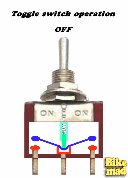

« Reply #14 on: June 04, 2015, 01:42:26 AM »
Here's a nice animation that clearly shows how the switch contacts typically operate inside an "On-Off-On" toggle switch:
In the Off position, the spring loaded plunger is extended and exerts less pressure on the the rocking contact. In addition to this, if the contacts have arced together the pressure being applied in the Off position is only a couple of mm from the fulcrum point whereas the stuck contacts are about 8mm from the fulcrum so they have a mechanical advantage of around 4:1.
This means that the little spring would have to exert four times the force required to break the contacts apart in the Off position.
If the contacts are stuck together and you push the switch across to the other side, the spring will compress more, but more importantly, the rigid plunger housing would exert direct pressure on the rocker arm forcing the contacts to be released.
You can see what I mean by placing a piece of paper on your monitor with its edge running along the upper side of the rocker when it is fully raised, you should notice that the end of the plunger housing (switch shaft) will disappear behind the edge of the paper at the point at which it would press against the stuck rocker arm.
I suspect that the reason your switch releases when you flick it quickly is because the plunger flicks quickly into the recess in the middle of the rocker arm and the sudden impact is probably enough to shock the contacts apart. When the switch is moved slowly, the plunger gently slides into the recess with no impact force. Unfortunately I cannot think of an electrical way of overcoming the problem.

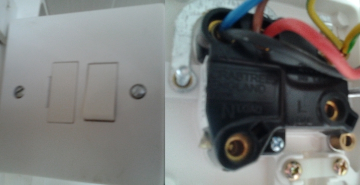

Dennis, unfortunately not all electricians are equipped with common sense.
I have had two incidents over the past five years where I have been working on 240V electrical equipment, after turning off the isolator switch and removing the fuse for additional safety. On both occasions I was fortunate enough to just receive a tingly zap as a warning, and on further investigation the cause was incorrect wiring of the fused isolator switch.
In both cases the incoming mains supply and the output for the equipment had been placed together in the same connections instead of one in the input and the other in the outlet:
So not only could I have been electrocuted, but the equipment that the fuse should have been protecting was not even fused.
Imagine what might have happened if I had undone the mains cable from the appliance end and the live wire touched against Neutral or the metal chassis that I probably would have been holding. :o
I now test electrical appliances with a voltmeter to make sure they are "safe to enter" before I go anywhere near them as I have lost all confidence in so called electricians, and knowing my luck it might be third time unlucky!
