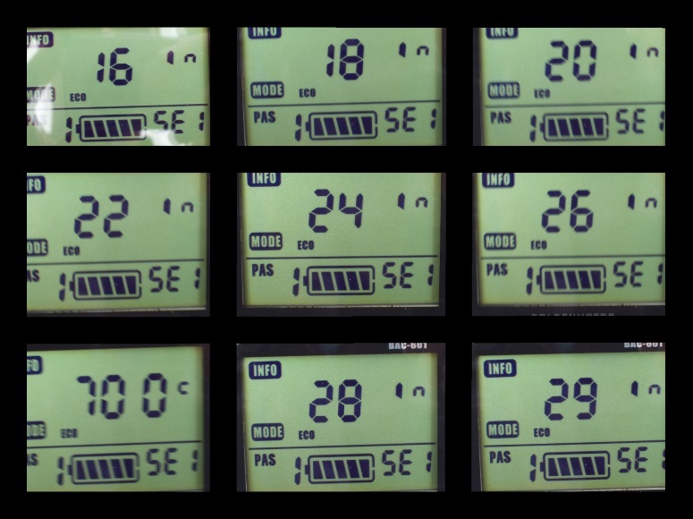

There is NO setting for 700c. There are various settings for each of the sizes: 10.0 to 30.0.
I have just checked mine out and it appears to be the same as stated in the original instructions with the added bonus of the 29" option:
I also had a quick look at the adjusting factor and it allows any of the standard sizes to either be increased or reduced by up to 30% in 1% increments:
« Last Edit: July 05, 2017, 04:07:07 PM by Bikemad »
