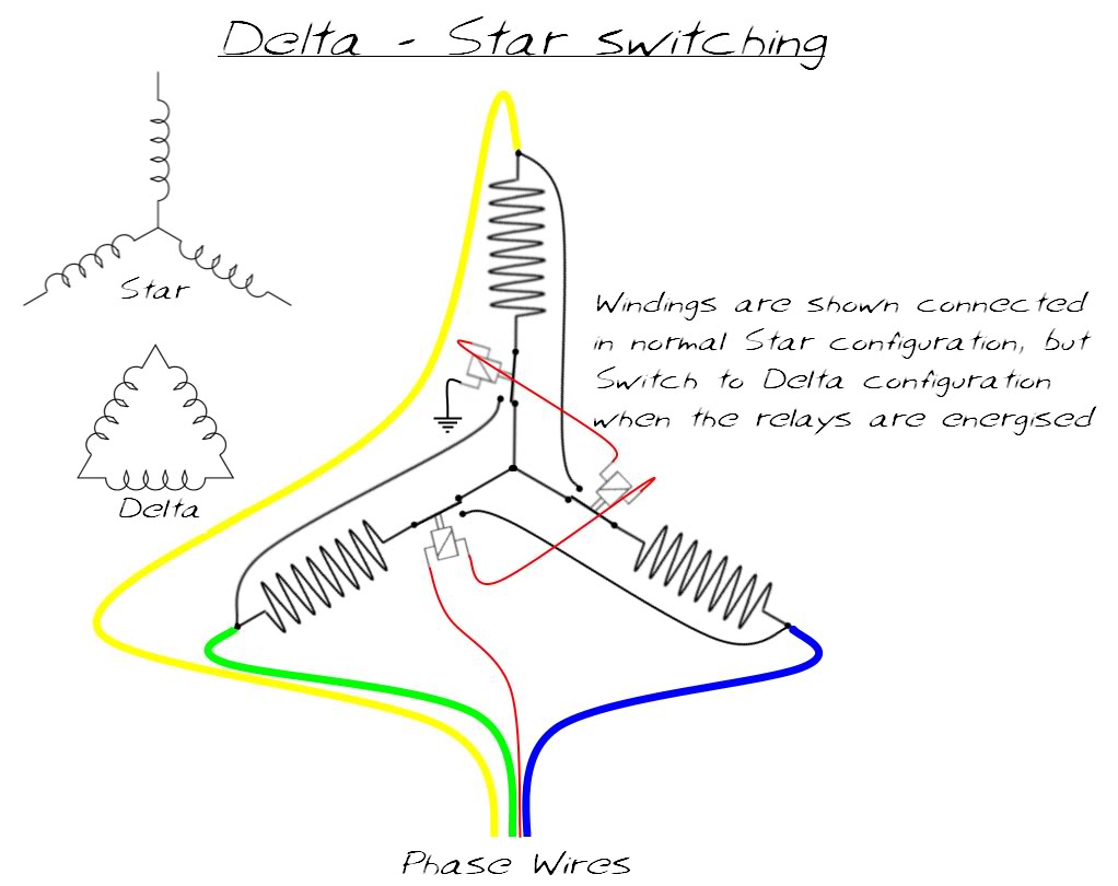

Re: Review of the Newest MP4
« Reply #17 on: December 16, 2014, 06:38:16 AM »
Hi Laurance,
I want to apologize in advance for being a terrible person.  I am not questioning you to hurt your feelings, but to learn.  An Aussie called me a bully a while back, and wanted me kicked off the board, and I am still stigmatized by that.
So…….
I agree with much of what you say, but the question I had was : how do laminations affect motor torque and speed?  You say thinner laminations  are quicker, and that other motors use 50mm 35 mm and 20 mm:  So Why?  Why are they quicker? and what does GM use?  (PS: 20 mm laminations are way thicker than I have ever seen.  I have never measured them, but I would guess most of the motor laminations I have seen were a vey few tenths of mm thick)
That being said, regarding loss of a winding; in my experience, it won't matter which way the motor is connected: you are screwed.

« Reply #18 on: December 16, 2014, 12:33:35 PM »
Dennis, I think Laurence was talking about the overall thickness of the stator core, not the individual thickness of each steel laminate.
The stator core is constructed from laminated steel plates instead of a single solid piece of steel (~35 layers on the Magic Pie), as it greatly increases the stator's efficiency by increasing the resistance and surface area which reduces unwanted heat generation and loss of energy by reducing the induced eddy currents within the steel core.
Although the thickness of the individual laminations will have an effect on the efficiency of the motor, I'm not really sure how much it would actually affect the speed of the motor (rpm/volt).
If you use the same gauge copper wire and the same number of turns on each coil, the total length of the windings will be much less on a thinner stator than it would be on a wide stator, therefore the resistance of the windings will also be lower on the thinner stator allowing more current to flow from the same applied voltage.
Shorter windings and higher current usually results in a higher motor speed, which is basically why the speed increases when you switch from star to Delta:

I understood how the wiring affects speed and torque, and how lamination thickness affects I(2)R loss, but didn't twig to the core thickness affecting the winding length and turns and thus the speed.   Thanks.
By the way, electronically switching the connections  (VS relay) is a bit more complex than I first thought.  I didn't immediately consider the bidirectional circulating currents.  I must be getting too old to think.  I still think you have a great idea… Using Laurences number of 1.73, that is a nice ratio for a two speed tranny.

so if I had a r and d department I would build a controller that would shut down on the up shift for a second and then not let it shift back down until the motor reaches a safe speed and if it is a issue ,monitor all phases for balance and if a hazard rears its ugly head shut the controller down
some where I saw a diagram that they use 3 more fets to do the y delta switch on top of the 6 fets for just y
and that is a standard ac motor winding switch and that's what im use to

the y has two winding in series and im ok with that
the delta has two winding in series paralleled with the third one
and that is standard for a ac motor ,but do you need to do this
why cant you switch one winding at a time in a delta  set and do not feed the winding in series anything
« Reply #23 on: December 17, 2014, 11:51:09 PM »
Hi Laurence
Your question about using only two windings beats the hell out of me!  But I do know you will have to do something with the third winding, as there will be a current induced in it.

kit I would love to know
dennis they have one winding in y that's not used when the other two windings are run in series, why cant they not use two windings in delta and just do phase a -b-c
« Reply #27 on: December 18, 2014, 07:22:08 PM »
Hi Laurence,
The third Y winding is not energized  directly by current from the battery thru the H-switch, but the magnetic fields will induce a current into that coil.  There are diodes in the H-switch drivers that effectiively ground that end of the coil, while the other end is always connected to ground.  That keeps the voltage across the coil from going really, really high and damaging things.
Does that make any sense?
