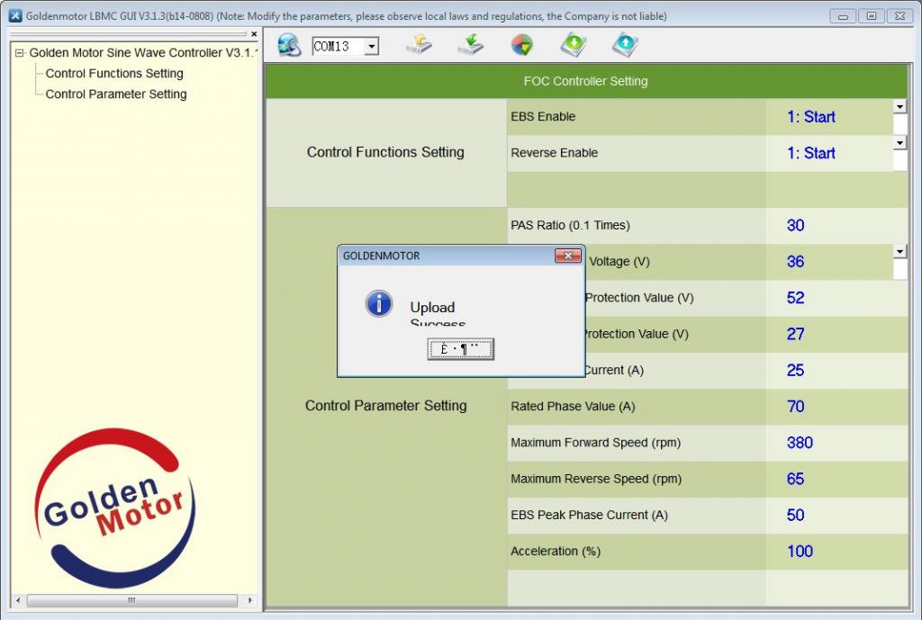

A screenshot that shows the warning/window to connect the device.
Staying young thru our toys.
Re: Programming the Vector Controller
« Reply #23 on: September 12, 2014, 01:58:43 PM »
I noticed that you are using a later program which I have just seen on the GM website.
I have just downloaded and tried this particular program (V3.1.3) with two different vector controllers (original and revised) and it connects fine with both of them.
The only problems I noticed was the unrecognised font used on the message box buttons and the slight confusion over the program version number, V3.1.3 is shown in the title bar, but V3.1.1 is shown at the top of the left window pane:
