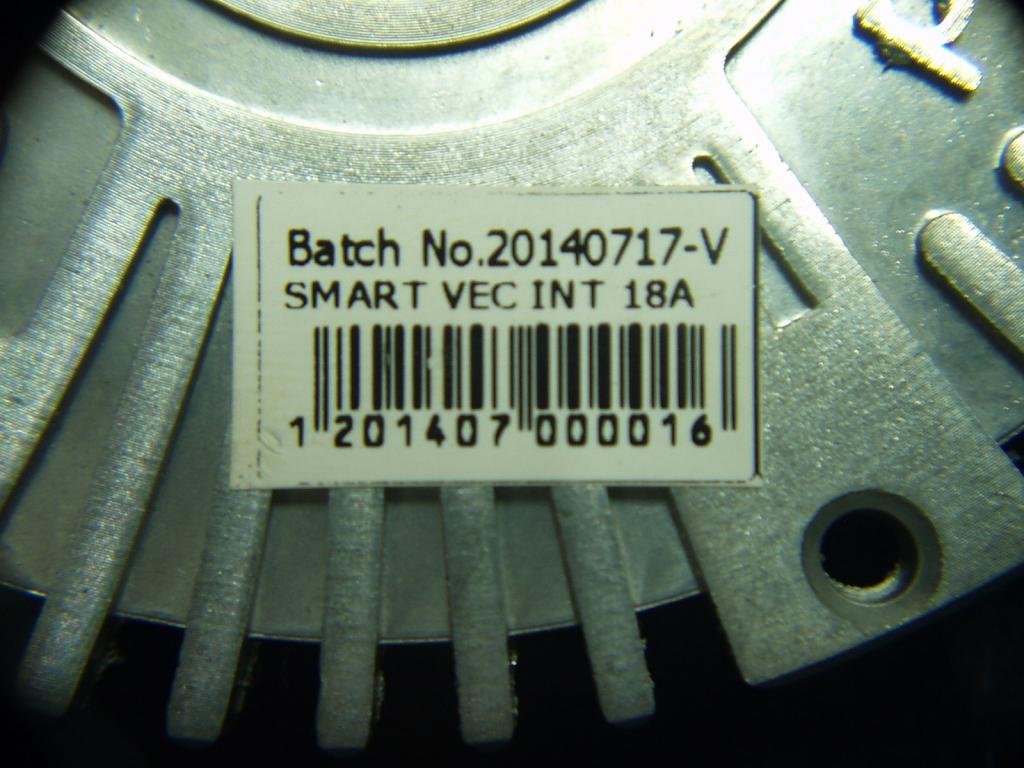

I haven't yet tried the Magic Pie, but I have tried a 700C front Smart Pie with the new vector controller:
The throttle response is amazing, but I had to reduce the acceleration setting as I kept spinning the front wheel while trying to pull away on loose surfaces because it was a bit too quick to respond on the 100% setting.
The other most obvious difference is the distinct lack of noise coming from the motor, I can now ride past pedestrians on pathways without them being aware of any motor noise.
I went for a bike ride with my wife (her bike doesn't have a motor) and she didn't even realise I had been using my motor until I told her, even though I was riding along right next to her for most of the ride.
