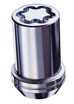

An alternative way of securing the axle would be to use locking wheel nuts:
Something like this would be much more secure:
But they're also a lot more expensive to buy.  ::)

Where do I get(online) that kind of nuts(as in the picture)?
Offline MagicJacob
  • Posts: 26
Re: Magic Pie III Axle securing with a "Pitlock" or a "pinhead" Nut Set?
« Reply #3 on: October 08, 2013, 06:21:14 PM »
I think I have found the locking nuts in the picture(they are originally intended for a car wheel)
The name is "McGard  Wheel Locks"
Here are a few links for M14X1.5
http://www.jegs.com/i/McGard/671/24210/10002/-1?parentProductId=
http://www.amazon.com/McGard-24210-Chrome-Wheel-Thread/dp/B000COTX34
Its not "pitlock" but is should be Ok.
Also got a response from "pinhead", they will be making  14mm nuts(solid axle) next year.

I'd be very careful with applying such Locks as they are meant for car wheels and therefor are self centering in a countersunk. As you can see the surface for the Nut to the fork is very limited compared to the original.
No normal fork does have such a countersunk. Even with a washer all the force is resting on a very small surface. With a high torque motor like the MagicPie you would just multiply the stress on the dropout (which is already in a "will surely brake soon" deathloop when you use Aluminium).
