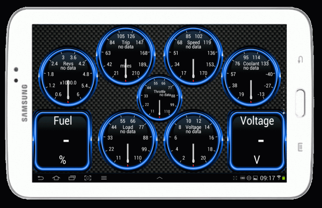

« Reply #6 on: October 16, 2013, 09:15:12 AM »
I think it would be much better if the controller was modified to allow Bluetooth connectivity so that programmable settings could be altered in real time throughout the ride using any Android device or Smart phone etc. This would  eliminate the need for a separate programming cable.
It should also be possible to transfer real time information via Bluetooth for monitoring battery voltage, current, rpm, temperature, calculated power, speed and distance travelled etc:
I would also like to see an adjustable cruise control which controlled the motor power and the regenerative braking force to maintain a constant speed down hill, up hill and on the level.
