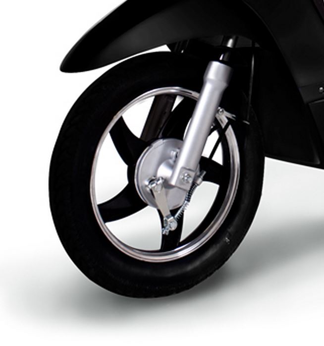

Hi, I am looking to upgrade my Emmo X brand scooter by adding a front motor.
I realize other companies may make a very similar model of this scooter, however... here is a link with some specs of my scooter. http://www.emmokingston.ca/thex.htm
I have 60volts worth of batteries on the scooter at the moment, and it is running at 60 volts, and has been for about a year with no problems.
I am looking to add the Magic Pie III 16 inch to replace my front wheel, and buy some batteries to hook up to it. I already know how to mount these extra batteries, and it is not the issue.
I am merely wondering if the 16 inch version of the Magic Pie III will fit this Emmo X model bike.
Maybe someone out there knows enough about this situation to offer me some helpful tips.
Also, would I be able to use a thumb throttle on the front engine, and mod my handlebars to keep my current twist throttle on my rear engine? Is there an easier way to do this?
Any help would be appreciated, as I love my bike, and the police in my area are VERY relaxed about ebikers and their ebike mods, as it is a small town. No harm no foul.

Unfortunately it would not be very easy to fit the MPIII to those front forks for the following reasons:
  • The axle fixings are totally different, the MPIII has a solid axle with machined flats to transmit the torque for power and regen and a retaining nut on each end, but the Emmo simply uses a long bolt which passes right through the forks and hub assembly which can be easily withdrawn to remove the complete wheel asembly:
  • The Emmo is equipped with a drum brake, which cannot be used with the MPIII.
  • There is no easy way of attaching a disc brake caliper to the Emmo's forks to suit the MPIII
I am not saying that it can't be done, it's just that it would require a lot of hard work involving some precise measurements, detailed component design and some fabrication using precision machining tools.
It might be easier to upgrade the rear motor and speed controller to produce a lot more power. ;)

As Alan pointed out this would likely be a lot more difficult then you think.
It appears from your picture the wheel is placed in the forks and an axle is then pushed through ans secured. On hub motors the axle is permanently mounted in the motor. It can not just push out. So your forks would need to be modded or separated to mount the motor.
The next issue would be the axle shape of the axle. Your axle is likely round, hub motor axles are oval in shape. This prevents the axle for spinning in the dropouts..
The next issue would be the brake. It appears you have a drum brake. Not sure how that would work out. I'm not clear on what the brake is on the MW16.
Now about stock. When I was down to two mw16 I ordered six more. I sold those two and four more I have not received yet. So only two will be available. Now this is starting to sound like a sales pitch. This was not my intention. I only jumped in this thread to correct some miss-information on my website.
My conclusion is the same as Alan's. this would not be easy. Personally I would recommend not attempting it.
