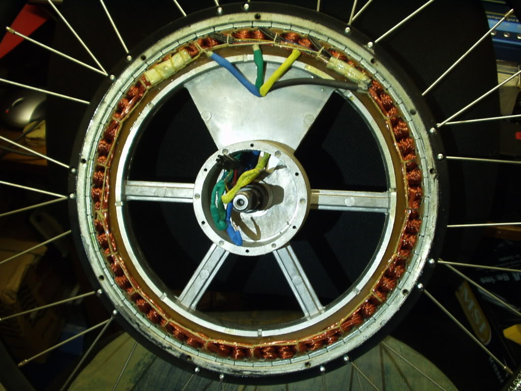

I'm guessing that you removed the original semicircular heat sink plate (as well as the internal controller) when you converted to the external controller:
In which case you will have inadvertently reduced the rigidity of the stator allowing it to flex more in a torsional direction under load.
Constant flexing can cause metal fatigue in the radial spokes of the aluminium stator casting, which could eventually result in the stator spokes cracking or even breaking apart completely:
Click image to enlarge.
My money is on a failed stator, but we will just have to wait and see what you find when the wheel is dismantled, and I really hope for your sake that you can prove me wrong.

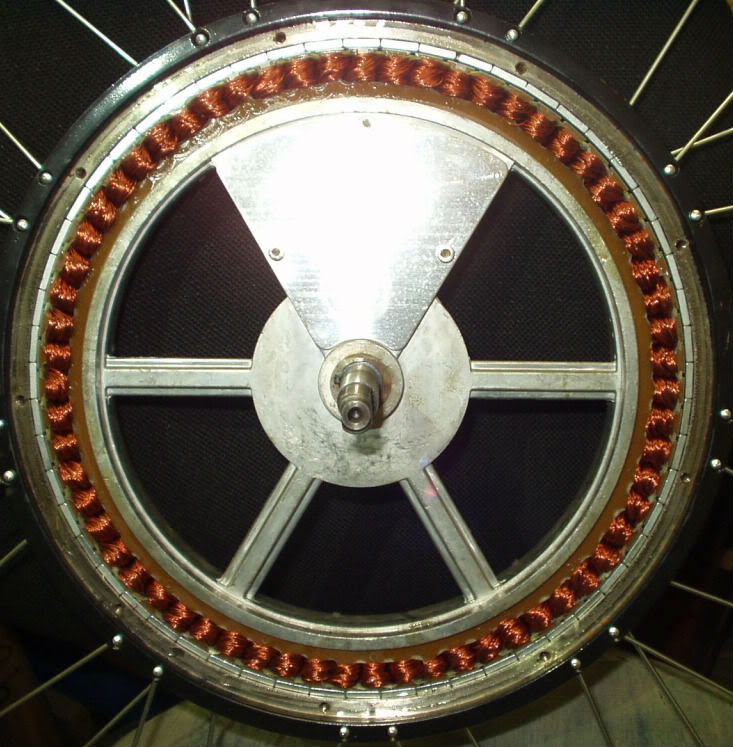

Magic Pies with internal controller have a semicircular heatsink plate bolted to the stator spokes as shown here:
This plate (whether intentionally designed to do so or not) also helps to stiffen up the stator spokes and therefore reduces the amount of torsional wind up within the stator itself when under load.
