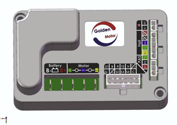

With the battery turned on, place the black negative meter probe into the "Z/0V" connection and the red positive probe into the "T2" connection. If everything is working correctly you should have a reading of ~0.8V with the throttle released and it should vary between ~0.8V and ~4.5V when the throttle is operated.
If water is allowing electricity to flow from the battery feed wire in the harness or throttle, the throttle signal voltage at "T2" is likely to be higher than 0.8V, and if the reading is higher than 1.25V with the throttle released, the motor will be unable to run due to a power safety feature within the controller, and you will have to carefully check the connections and throttle unit to try and locate where the water has found its way in.
Thoroughly dry the connections and apply some petroleum jelly (Vaseline) on the connector plugs to try and prevent any water from re-entering the connector.
You can easily test the motor on the external controller by carefully following these instructions:
  • Unplug the 12 way connector plug from the controller.
  • Make sure the powered wheel is securely raised off the floor and unable to touch anything when it suddenly spins.
  • Turn on the battery power.
  • Use a paper clip or a piece of wire to momentarily make a connection between the "T1/5V" pin and the "T2" pin on the controller socket.
If the battery, controller and motor are all OK, you should find that the wheel will instantly spin at maximum speed while the two connections remain joined.
The battery must be turned on before the wire is used to bridge the two connections, if the wire is already in place before the battery is turned on the motor will not run!
Measuring the resistance across throttle pins may work with a simple variable resistance throttle, but is not a good way of checking a hall sensor throttle. You really need to check the voltage on the output signal wire as previously mentioned above.
I measured the voltage between "Z/0V" and "T2" and I had a reading of 0V (actually it was ~0.6mV, but it wasn't very different from when the probes are not touching anything at all), no matter if the throttle was operated or not. It was very difficult to insert the probes into the connector (so that they touched metal parts of connections) so I can't guarantee that I measured the voltage correctly, but I tried many times and the result was always the same.

I suggest you re-check the voltage on the "T1/5V" connection with the 12 pin connector plugged in by inserting the black meter probe into the "Battery B-" connection (ensuring it has good contact with the metal connector) and then use a paper clip or safety pin etc. to get far enough into the connector housing to make a good contact with the "T1/5V" metal contact inside the 12 pin connector.
If you cannot get a 5V reading with the 12 pin connector plugged in, try unplugging the pedelec (PAS) connector before checking the voltage again.
If you can consistently get 5V with the pedelec connector unplugged, but it falls to 0V when the connector is plugged in, I would suspect a short circuit between the 5V feed "P1" and the ground connection "P2" somewhere on the pedelec sensor wiring.
If you cannot get a 5V reading on "T1/5V" with the pedelec unplugged, try unplugging the 12 way connector at the same time and then check the voltage on "T1/5V" again.
If it then reads 5V, I would suspect there is a short between the +5v throttle feed and the throttle ground connection either on the throttle lead/throttle unit or the main harness (dependant upon how your throttle connects to the controller).
However, if you still cannot get a 5V reading on "T1/5V" with both the pedelec and 12 pin connectors unplugged, try also unplugging the hall sensor plug and checking the voltage on "T1/5V" yet again.
If you now find a good 5V reading on "T1/5V" (which was not present when the hall sensor plug was plugged in) you will need to look for a short circuit somewhere on the hall sensor wiring between the red 5V feed and the black ground connection.
Please note that as the throttle unit, pedelec sensor and motor hall sensors all share the same common 5V supply and ground connections, so a short circuit to ground on any one of these 5V supplies will prevent the motor from running.

I get a 5V reading on "T1/5V" every time (regardless of what's connected), it seems to be no problem with that.
However,  I've done my best, but I still get a reading of 0V on "T2" (not "T1/5V") no matter if throttle is operated or not. It seems that I insert the probe into the connector correctly, because I immediately got a reading of 5V on "T1/5V", but 0V "T2".

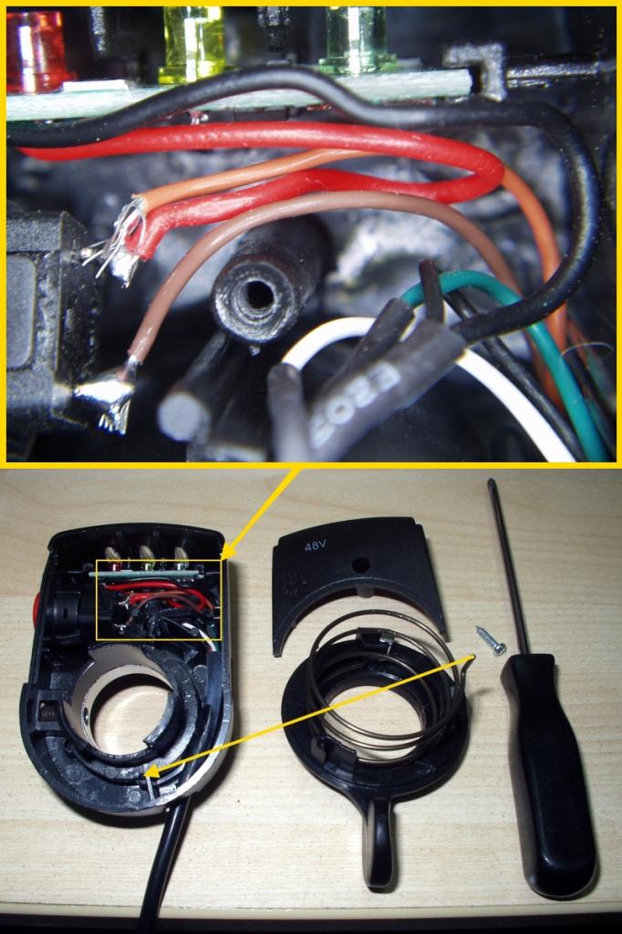

I think you may have a problem with either the throttle hall sensor or the wiring that connects it to the controller (unless the controller has somehow shorted out the throttle signal internally).
If the throttle hall sensor is receiving a 5V supply but its signal output is still 0V, either the hall sensor has failed and is no longer sending out the correct signal voltage (between 0.8 and 4.5V) or the signal output wire is shorted to ground somewhere which is causing the 0V reading.
If you have a soldered connection on the signal wire between the throttle unit and the controller connection "T2", I would suggest unsoldering it first and then re-checking the output voltage on the throttle side with the wires separated.
If the voltage is still 0V on the throttle signal wire (with the wire separated from the controller) it is probably just a failed hall sensor and not a controller fault. But if the signal voltage is between 0.8 and 4.5V (with the wire separated from the controller) the throttle signal wire going to the controller will be shorted to ground somewhere in the controller's external wiring or even inside the controller.
If you have the thumb throttle, it can be taken apart quite easily to check voltage readings on the three wires connected to the hall sensor.
In the following picture the Hall sensor wires are as follows:
  • White = +5V
  • Black = Ground (0V)
  • Green = Signal output (0.8-4.5V)
Use a clean sharp dressmaking pin or small safety pin to puncture the insulation of the wires to allow the voltage to be measured by touching the voltmeter's red probe against the pin (black probe connected to "Battery B-" terminal again).
Unfortunately, if you have the twist throttle, it is very difficult to take it apart without damaging the plastic cover, so it is not very easy to check the wiring inside.

Thanks for all the information and the pictures of a throttle. I'll open it up and will try to fix it :)
