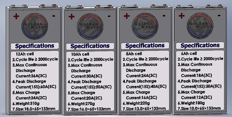

True the discussion is about cells, but the title is "Battery". Most people dropping in here would not be building their own battery. Most people would just be looking for a reliable battery. But I guess that's beside the point.
So what info on the GM cells would you need?

Really I'm the least technical person to attempt these answers, but lets start with this.
That should cover questions 3 to 6.
1 - I don't even understand the question
2 - Can I just measure this with my meter?
7 - fully charged 48v pack 58.4 low cutoff I don't know. But I guess you are looking for min/max per cell?
4 out of 7 with only 1 minute of research, not a bad start..
Now you tell me, are any of these numbers any good? They look to me to be OK for the average consumer. But as I said. I know nothing!
1. I think the answer to number 1 is LiFePO4
2. You can use the Cycle Analyst to measure the internal resistance. The cycle analyst 3 has a screen (I think it is two steps to the left) that shows a value with a omega sign behind it. As far as I can understand this is the internal resistance of the battery calculated from voltage drop over current draw. I haven't gotten this confirmed though as the documentation for the CA3 is very limited at the moment. The value is very close to my own calculation of internal resistance so I think that is what it is.
If you don't have the CA3 connected to one of your bikes you can use the old one, but unless I am mistaken you have to do the calculation manually.
7. As he said this is dependent on the technology so you only need the cell count and technology to figure this out. But listing the LVC and HVC of the BMS is always reassuring if only to see that things are as expected.

I need to know an internal resistance of the cells - it's very important parameter. Some of the LiFePo4 cells on the market have an internal resistance of 100mOhm - not acceptable at all! As for me, I see a warning/stop sign when a manufacturer doesn't include an internal resistance parameter in his cells spec.

After a 10 k power ride with one battery and two pies I have some statistics to toy with. The test battery is a 48v10ah LiFePO4 aluminum cased GM battery with about 400-500 cycles run through it by now. The battery is configured in the CA3 as a 16 cell 10 Amp LiFe battery. The number beside the ohm symbol on the CA3 is .179. If I understand correctly this number gets divided by the number of cells in the battery to determine the individual cell internal resistance. So .179/16 = .011.
The voltage of the battery is 53.4 volts at rest. with several hard dual MP III full torque take offs and 10 k of hard riding vmin droped to 39.9 volts. and Amax went to 56. SO now we have
((volts at rest - Vmin)/Amax)/number of cells)
 ((53.4 - 39.9)/56)/16) = .015
So I could be mistaken but those numbers seem pretty good to me. Of course I could be calculating this all wrong as well. What do I know  :o
And yes I realize a 56 amp draw on my 48v10ah battery is not good but I could not figure out how to set the CA for 48v30ah and run all three in parallel. It seems when I do 30 amps 48 cells it thinks my battery is a 153.3 volts of something like that. So I just did this test with one.
