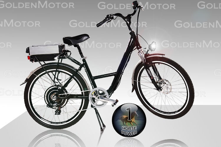

Those forks look exactly like the front forks on the Golden Motor Joy Ebike.
I use a set I cut offa joy Ebike for trying and testing wheels.
Actually I just mad a video using those forks. If they are the same they are incredibly strong.
http://www.youtube.com/watch?v=BPxOKDIz0_A
The brand name on mine is Zoom, but I hardly think that means anything these days.

Cool stuff, that video it showed me a couple of little things I needed to know, my brake caliper seems to even fit, I may just need to shave 0.5mm off them to centre them on the disc. Just got to fit the forks to the trike and order some batteries to get it all together.
I also liked the info on Reverse as I'm planning reverse as a parking option seeing it's a trike.
