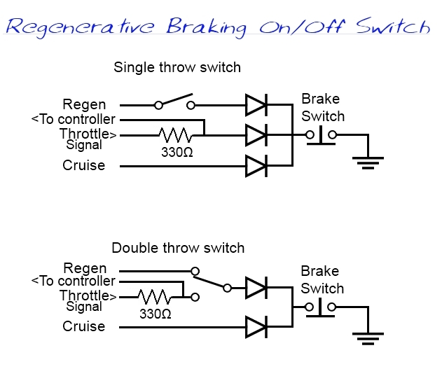

Les, if the throttle signal and cruise wires were connected to the same brake switch through separate diodes, it should disengage the cruise mode as well. Because the cruise control does not engage at zero throttle, pulling the lever would hopefully not active the cruise function, even if the throttle was held wide open at the time.
A simple crossover switch could be used to switch regen on or off using this method so you could temporarily disable the regen for downhill braking on a fully charged battery.
Did you have a 330 ohm resistor in the throttle signal wire (as required for the Cycle Analyst), or simply short the throttle hall sensor output directly to ground?

Yer I thought about a resistor but then I thought this is what the Hall does anyway, and most importantly the voltage + wire to the throttle is a tiny bit lower than the standard 5v rail as there is already a resistor on the throttle red wire in my controller and even the load of my voltage probes initiates a v drop. Providing I used the correct wires its all good,
Quite possibly and I am more sure about this, with the GM controllers, what I've done by shorting out the hall output, would 0V out the hall output signal initiating a hall failure code and beeps would occur. So id say add a standard diode to the brake switch 5v wire would be more advised, just enough to allow .8v through to the throttle signal via the brake switches. None of the 5v wiring are resistor unprotected on my controller and this ensures along with the resistance added by the hall sensors such ground shorts don't draw too much current and ruin the throttle hall or 5V rail regulators
May I ask where the supposed diodes go on your idea?  Before the switch and hall, on the output ground side on the switch and hall output.  This is all a little bit complicated to contemplate as to what is going to occur.  I had a long response to this idea but it all fell apart, but I am interested.  I get the cruise wont initiate at 0v throttle part but am confused as to how giving 5v from the the cruise wire to the controllers throttle signal wire in one image in mind of what you suggest is going to work?
Les,
A diode is fitted in series with each of the two signal wires (throttle signal and Cruise signal) and the brake switch contact.
Each wire has its own diode that will allow the current to flow to ground via the brake switch, thus preventing any back voltage or grounding via the other signal wire from affecting the independent operation of each circuit.

Re: Regenerative brake switching
« Reply #7 on: July 10, 2012, 03:40:29 PM »
This is what I meant:
I have some scribbled down diagrams somewhere of a similar circuit that I devised for dual motors that would allow independent regen linked to each of the brake levers.
Both brake levers would instantly cut the throttle, but front and rear regen would only work with the respective brake levers.
