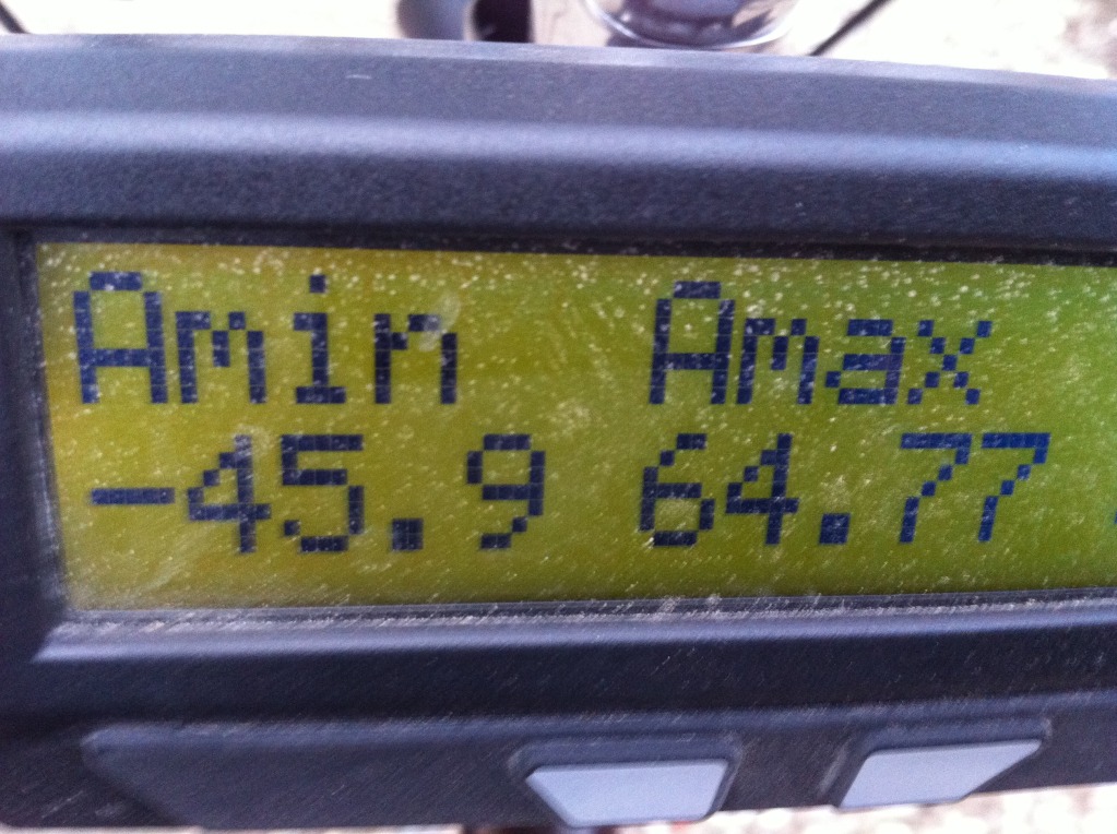

MPIII Regen issue
« on: May 01, 2012, 06:59:21 AM »
So, tonight I finished installation of a Cycle Analyst (which BTW I love!).  Having ridden a few miles I'm noticing I may have a regen issue.  When I hit the handbrake enough to activate the regen brake the Cycle Analyst indicates approximately a -6.5 amp charge going back into the battery BUT only for about 1 second.  The motor brakes all the way to a stop but as far as the Cycle Analyst is saying it's only putting power back into the battery for about 1 second.  Over the course of a 4.5 mile (2.1AH consumed) ride with many stops from 20-25mph to 0mph I managed only about 100mah put back into the battery.
Any ideas?
