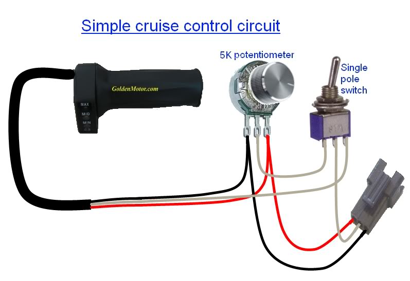

The cruise control sometimes is sooooo hard to get right....ive got mine set for 3 seconds, but you have to hold the throttle dang still ...sometime for 6-7 seconds, but if the road is bumpy, you cant get it righth every time, but apparently this is a 12 fet board problem only...90% oof the time its fine....
If you have room for a 5K pot and a two way switch you could have a manually adjusted cruise control and simply switch between throttle and the last set cruise speed. You would simply adjust the pot to get the exact cruise speed that you want.
With a bit of ingenuity, it should be possible to rig up a single push button to activate a small crossover relay that would automatically switch off again when the brakes were applied. It would automatically return to the last set cruise speed when you pushed the button again.
With all that power, you'd have to be careful that you didn't accidentally switch on the cruise function from a standstill. :o
Perhaps you could use the throttle signal voltage to operate the relay via the push button so that the cruise function could only be switched on while the throttle was being used.
If you used a couple of diodes, you could have the cruise function working in conjunction with the throttle, so that each one could override the other.  This would allow you to increase the throttle to provide more power on steep hills etc. and then just release it to resume the set cruise speed, so you wouldn't need to reach for the cruise switch every time you want to quickly accelerate past slow car drivers and non ebikers!  ;D
This should at least give you something to think about. ;)
