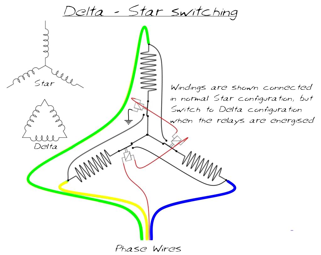

Anyone know how can I fool the controller about phase resistance?
Unfortunately I can't see an easy solution to it. Changing from Star to Delta effectively reduces the resistance across each pair of phase wires to a third of what it was before, which also means that the current across each pair of phase wires increases to three times that of the Star configuration for the same voltage.
It seems that the GM internal controller does not like working three times harder than it's supposed to. ;)

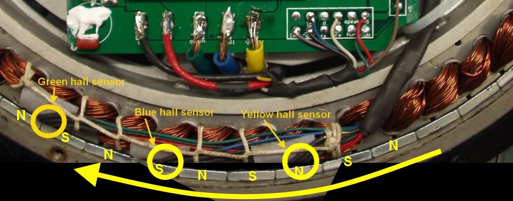

Now I'm confused ??? in my original diagram, I presumed that the phase order was "Yellow - Blue - Green", because this is the order in which the magnets pass the hall sensors on my Pie when the wheel is turned in a forward direction:
That would mean that:
                              The Yellow phase lead connects to the switched end of the Blue windings
                              The Blue phase lead connects to the switched end of the Green windings
                              The Green phase lead connects to the switched end of the Yellow windings
As shown in my original diagram here:
But you say that you've connected your leads like this:
                              The Green phase lead connects to the switched end of the Blue windings
                              The Blue phase lead connects to the switched end of the Yellow windings
                              The Yellow phase lead connects to the switched end of the Green windings
As per this modified diagram:
Now I'm not sure which one of the above diagrams is actually correct for the Magic Pie.
Either I've got the phase order wrong, or your pie is different to mine, but I'm not sure how can we find out for sure which of the above diagrams is correct, unless you want to pull your hub apart again and try changing your connections and see what happens? :o
« Last Edit: June 30, 2017, 09:56:22 PM by Bikemad »

Bikemad your first diagram is ok!!!
1a - 2
2a - 3
3a - 1
the a was on the wrong side my mistake, gues I was a bit too quick writhing this  :-*
