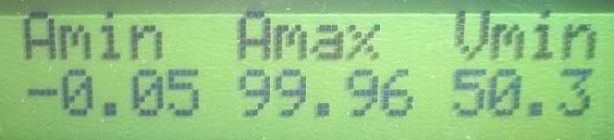

Fresh off the charger with my more conservative software settings im getting 30.42 amps max at 51.6v thats 1569 watts.
In the software with the shunt mod installed the constant current is set to 13 amps but I get 20 amps, and max is set to 25 amps but I get 30 amps.
I may need to go to 36v mode.

I just took it for its first real run with the 10 amp shunt installed.  The ride consisted of 4 hills 2 short steep hills one small hills not so steep and one moderate hill.  I think I would climb 100 meters on this ride maybe.  Typical of my over all usual usage.
Much better on the roads,  I measured my wheel circumference and calibrated the CA it was close enough at default.
I did 7.80 kms and consumed 1.93 ah.  Top speed 35kph.  Thats 247ma per KM 12.08 wh/km
