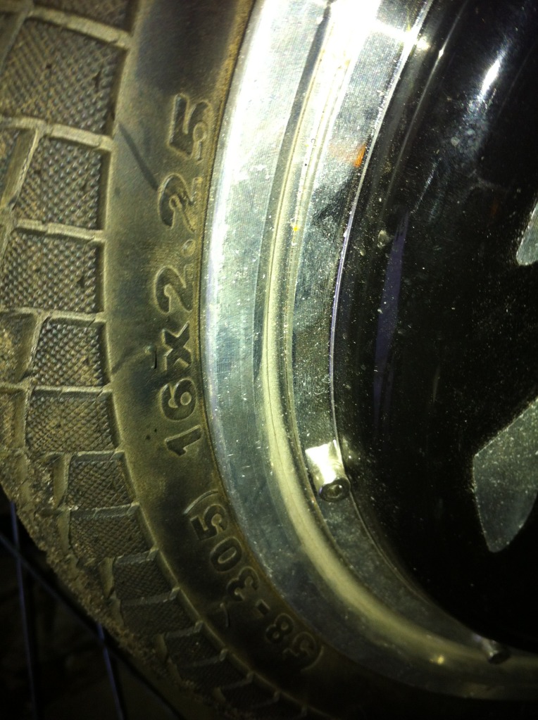

« Reply #25 on: March 06, 2012, 01:06:03 AM »
Recently I was asked what fits on the 16 inch Magic Pie. I had a 16x1.75 tire on mine originally, now I have a 16 x .2.25.

« Reply #28 on: March 15, 2012, 04:54:32 PM »
The local supplier told me to look for the INSIDE diameter, not the overall diameter - as I could find a much better fit.
GM 20" cast wheel = 16" Inside diameter. Searching for this size has generated many more options.
After just helping a person with finding a tire to fit his cast 20 inch wheel I read this post and went to google to search for tires. I found this link.
http://cyclocamping.com/blog/2015/08/01/what-do-size-markings-on-bicycle-tires-mean/
This is excelant in describing the issues people have with finding appropriate tires. The ETRTO standard of measuring tires by the inside diameter is far better then the Imperial standard of measuing tires by the outside diameter. If you look at this link you can see that tires are available in 7 different inner diameter measurments and they still are considered 20 inch tires.
