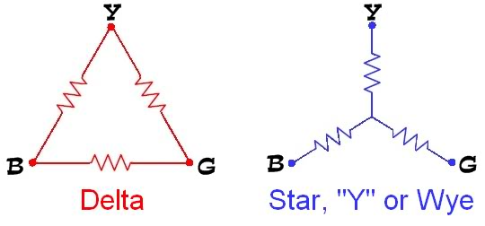

I'll have to pass on questions 1 and 2, but question 3 is a bit easier.
You definitely should have continuity between the three phase wires as the are all connected together in a star pattern as shown in blue here:
Testing between GND and each wire I get 3K resistance.
You would need to unsolder the winding leads from the controller to get a true measurement between the windings and ground, but as the controller should not be connected to ground via the stator assembly you should be able to easily check with the battery cable disconnected.
There should be no continuity between the windings and chassis ground (axle and stator casting etc.) because they should be completely insulated, but if the 3K resistance you have measured is between the windings and battery ground (black cable), this might be perfectly normal, as you could well be measuring a high resistance to ground through some of the components in the controller itself.
