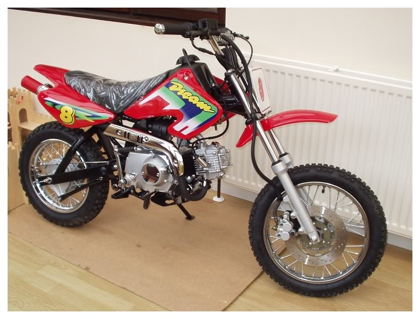

I just took some measurements from the spokes on my kids motorbike:
and they appear to be 3mm diameter, whereas GM spokes are 2.55mm, and the diameter of the nipples that go through the rim are approx 5.8mm instead of GM's 4.5mm.
