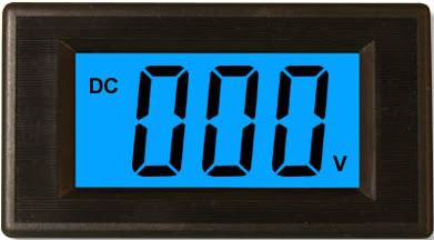

I will be using a separate voltmeter so I can hopefully keep an eye on my battery level: ;)
The large LCD display should be easy to read in the sun, and the back-lighting should be good in the dark.
An audible battery monitoring unit will also be fitted for when I'm not paying attention! ::)
