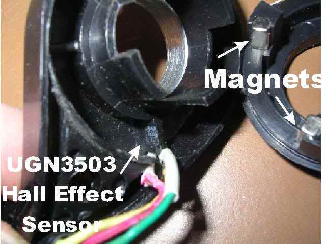

Ok, So today I tried to take apart the throttle. I wanted to see if I was able to directly draw some wiring from there to my cycle analyst.
Would not trie this as the plastic is not just screwed together but also glued. Putting it back together would require glue and taking it apart is taking the risk of unrepairable damage.
So here is the GM throttle
Opened up it looks like this.
You can see that the brown and yellow wire come together on the red switch.
The green wire goes to the batt lights and must be high voltage....... The red wire going to the batt lights actually is ground. This little red wire is connected to the black coming from the controller.
White red and black however run to a very narrow point.
I first thought this was where the wires were leading even deeper into the housing. After some closer examination I thought the Red Black and white came together here in a connector of some sort.
So I did some gentle pulling and wobbling and out it came.....  ;D
Examining even closer..... HUH  :P
What the....... is this?
Looks like a sensor of some sort. Could not read the fine print until I took this macro photo.
Have been Googling for this part S 49E 937
but cant seem to find any information.
I also checked what it could be measuring and I have discovered that the metal ring and moving part of the throttle actually is magnetised. So How would this work?

Jerry, you've discovered the Hall effect sensor, which is used instead of a variable resistor.
Being solid state, there are no moving electrical parts to wear or suffer from poor contacts. This means they are generally more durable and reliable than a conventional variable resistor (potentiometer).
Quote from: Wikipedia
A Hall effect sensor is a transducer that varies its output voltage in response to changes in magnetic field
The three connections are +5V (Red lead), 0V (Black ground lead) and signal out (White lead).
Twisting the throttle simply varies the strength and polarity of the magnetic field adjacent to the sensor, which sends a corresponding voltage of between 0.8V and 4.5V to be sent to the controller.

No no no. The magnet in the throttle is a long curved magnet and the sensor just senses the change from the north pole to the south pole as you turn it. I think the sensor is like a transistor, but is affected by magnetic fields.
Quote from: Bikemad/Alan
The signal out will then vary between 0-5v as it moves across the magnet field, signalling either 0% throttle up to 100% throttle. It can only be between 0 and 100%, you cant go higher than 100%. The only way to get more current is to modify the controller.

That part resembles the honeywell ss49e.  Often they Chinese make duplicates of the original part and name them almost the same.
http://sensing.honeywell.com/index.cfm?ci_id=140301&la_id=1&pr_id=128770
In your throttle it is horizontal yet the data sheet states the gauss is vertical from back to the front of the package.
With the answers more questions arise.
I am reading they may require a biase magnet or something but I am failing to find any such thing.
Maybe the effect of N S on the front of the package is enough to alter the resistance.
I think the sensor only detects changes in magnetic field and as it was at 50%
I think they latch the resistance to the last gauss field.
-1000 to 0 gauss = 0v to 2.5v
0 gauss it half throttle.
0 to +1000 gauss = 2.5v to 5v
Also 0 gauss = half throttle.  no magnet on a powered throttle hall will allow half the input to go to the output
I do think if you were to remove the magnet a powered hall remains at the last state due to N P polarisation of the medium.
Not sure really but from memory I had an incident where the throttle handle came off in my hand it latched.
Remove positive input and no output
Remove the ground input and you get full output.

Jerry, just to clarify; maximum throttle should give a signal voltage of approx 3.5V not 5V.
Between Black (Z/0V) and Red (T1/+5V) it should read almost 5 Volts.
Between Black (Z/0V) and White (T2) it should gradually vary between 0.8 and 3.8V (±0.5V) as the throttle is slowly twisted
