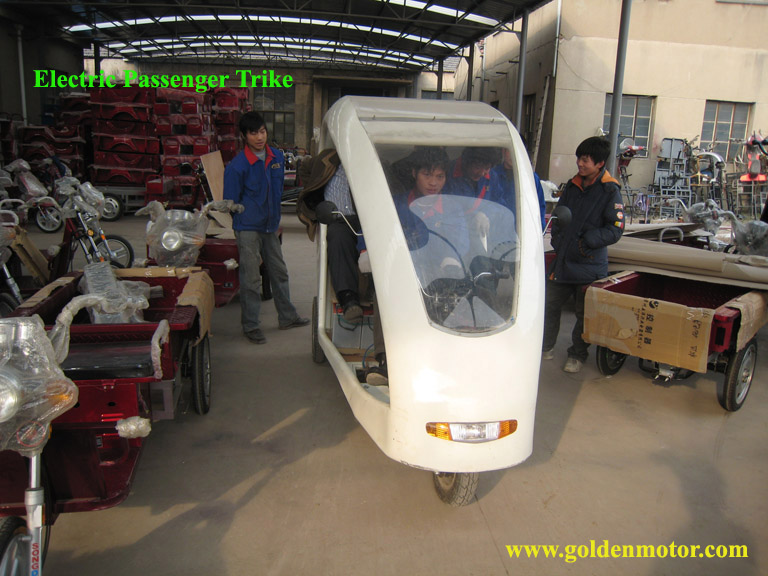

How may Goldenmotor employees can you fit into a electric passenger trike? Anyone know the number for Guiness Book of Records?

The answer is ... many many.
there were 5, given 5000W, so if you plug in the 10 000w that's coming out soon, then you can fit 10 ppl in. That's better than a BMW!

I realy like the 3 wheeled trike on the right.
In The Nethelands we call that a bakbrommer.
