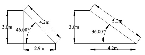

ooh I ment % , I don't know how to measure it or say it so it was 0 meter high and I drove up the hill and there it was 3 meters higher and the hill was 4.2 meters long.
I think your calculation must be off a bit.  If the hill was 4.2m long (hypotenuse) and 3m high (opposite side), then the horizontal distance was about 3m (adjacent side=sqrt(4.2^2 - 3^2)=3).  This is a 45 degree angle or a 100% grade.  Even a 50% grade would be a 25 deg. angle, a very steep incline.  I think you must be mistaken about this.  If you can test this on a known grade of some length, it would be a great help.
Re: Golden Motor Magic Pie reviews
« Reply #13 on: October 26, 2009, 01:28:20 AM »
Pdf,
I'm inclined to agree with you. (No pun intended)
Whichever way you interpret Kevin's description, that hill does seem to be rather steep!
