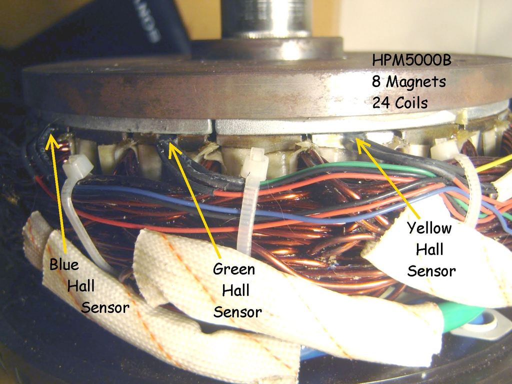

And it's not noticeably harder to turn over -without d washer- maybe because number of mags is identical?
The rotor on the 10kW motor should have 16 magnets (8 on each side of the rotor disc) whereas the 5kW motor only has 8 magnets mounted on just one side of the rotor disc:
Perhaps the magnets and stator coils positioned on either side of the rotor disc are staggered by 7.5° to reduce the residual magnetic drag and smooth out the electromagnetic pulses.  :-\
Although, this would mean that the coil timing on one stator would be out by 7.5° (either advanced or retarded) when a single controller using the single set of Hall sensors on the other stator was used.  ???
