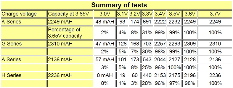

The following table from Powerstream.com shows some interesting results for variations from the typical maximum cell charging voltage:
At a maximum charging voltage of 3.4V per cell there was only a minor loss in capacity of between 1% and 4% compared with the 3.6V per cell for the four different types of 18650 LiFePO4 cells tested.
3.4V per cell seems to be a reasonable figure to use that can provide near full battery capacity combined with an extended lifetime.
If you regularly use an adjustable balance charger, I would definitely recommend setting the maximum cell charging voltage to 3.4V instead of 3.6V or 3.65V typically used for most LiFePO4 packs.
Unfortunately, most BMS equipped batteries cannot be changed.  :(
If you have a vector controller, and don't mind losing a little bit more of your battery's maximum capacity, then I would suggest setting the Undervoltage protection value (V) to 2.8V or even 3V per cell (i.e. 44.8V or 48V for the 16 cell 48V battery) to extend the lifespan of your battery pack even more.
