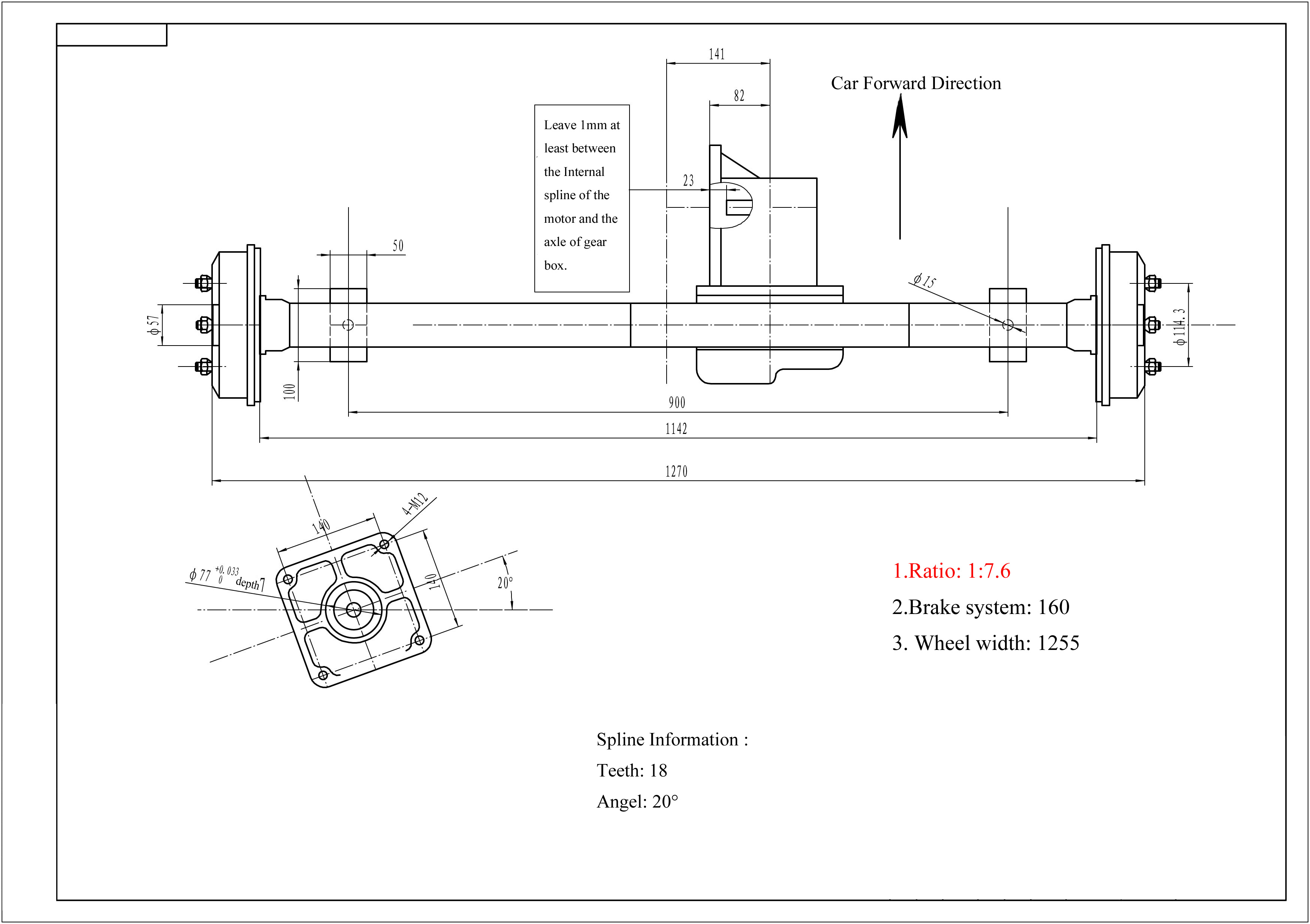

I have assumed your differential incorporates the 7.6:1 gear reduction as indicated on the current drawing.

we managed to disassemble the differential gear and attached is the number of teeth in the gear. now is in the process to design and fabricate the bracket for the massive motor  :o
any advise? might need to add few gear for the motor

According to the tooth count, your final drive has a total gear reduction of 10.27245:1 which is good for hill climbing but not so good for top speed.  ::)
The stated 160Nm of peak motor torque should produce ~1643Nm of torque at the wheel, which would provide a forward force of around 5370N (547kg) with 600mm diameter tyres. That's enough force to climb a slope of over 23° (43%).  :o
The top speed will be limited by the motor maximum rpm (which is probably going to be ~4800rpm @ 96V) and at 4800rpm it would only achieve a maximum of 32.85mph (52.87km/h) with 600mm diameter tyres.
