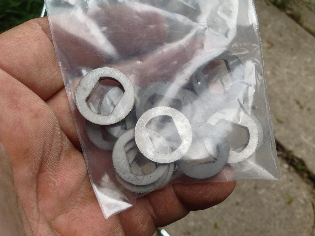

Here are two drawings with some dimensions for the Magic Pie 3, 4 & 5 front and rear motors:
The drawings don't show the dropout measurements including the thickness of the two axle washers that fit inside the dropouts:
But the motors usually fit most 100mm front dropouts or 135mm rear dropouts.
